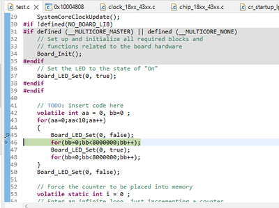

I've been following a few tutorials using the MCUXpresso IDE, but I am unable to run or debug any of the example code.
  1. https://www.nxp.com/docs/en/supporting-information/Debug_Probe_Firmware_Programming.pdf
  2. http://thomasweldon.com/tpw/lpc4370/lpc4370tutorial1/index.html
I am using two LPC-Link2 boards, one as a debugger and one as an eval board. JP1 and JP2 are connected on the debug LPC-Link 2, such that I can power on the eval board. Initially CMSIS-DAP did not work, so I configured the debugger as a Segger J-Link probe, which seemed to work. However, I am still unable to run or debug any example code.
Set up:
Error #1 for debug mode
Error #2 when breakpoint is added
New to micro-controllers, any advice would be much appreciated!

Hi @act642
I checked your video. you can connect, and debug board without issue.
If you want to run the project, click on Resume(F8) before Terminate. as I showed in my attached video.
Regarding to the run button problem you referred, I will report it. Thanks for brining the problem to our attention.

act642
Hi Jun,
It still does not work, sometimes I get the same issue.
I also always get this error if I try to run the project.
"Error starting process.
Cannot run program "C:\....\NXP\workspace\test\Debug\test.axf": Launching failed"
I think the board works, I was able to see the debug board flash the LED, but not the target board.
I was only able to step into the code by restarting the debugger and stepping into all debug sessions.
I expect to see a result like in this tutorial: http://thomasweldon.com/tpw/lpc4370/lpc4370tutorial1/index.html
However, I cannot get past line 46,

act642
Hi Jun,
I was able to recreate your video, but only when I open a "C project only". Previously, I was opening a "LCPOpen C Project". After debugging, I cannot run the code (see attached video). Do you know how I can successfully run the project?
Thanks for your help.
11,868 Views
ZhangJennie
Hi @act642
Have a nice day
Jun Zhang
