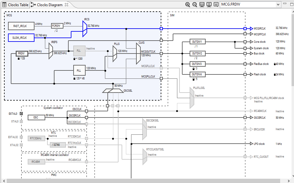

I am using MCUXpresso IDE v10.2.1 [Build 795] to program a FRDM-K64F board.
I need a delay function to generate a delay of milliseconds and microseconds, for this I am writing the following codes:
#define SOURCE_CLOCK CLOCK_GetFreq(kCLOCK_CoreSysClk)
void delay_us(uint32_t value)
    uint32_t d = SOURCE_CLOCK / 1000000 * value;
    uint32_t i;
    for (i = 0U; i < d; ++i)
        __asm("NOP");
void delay_ms(uint32_t value)
    uint32_t d = SOURCE_CLOCK / 1000 * value;
    uint32_t i;
        __asm("NOP");
I am testing the functions to blink an LED. The problem is that no matter the configured SystemClock frequency, delay functions always blink the LED at a frequency around 10 times lower than the SystemClock, in other words, if I call the functions as follows:
delay_ms(1000); // Spected delay of 1 second
the delay I get is about 10 seconds.
What is the problem?
Regards.
