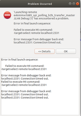

mzielinski
Hi Erich,
Thanks for restating your instructions, I was not doing it properly before, and the IDE would still look like it was trying to connect with USB. I think I'm getting slightly further now, but the error message I'm getting is confusing me. I don't understand why it's trying to connect to localhost:2331 when I definitely have the correct IP address specified in the Debug configuration. Have you possibly seen this before?Capture.PNG
Really appreciate your help on this,
-Mike
9,731 Views
ErichStyger
Specialist I
Hi @mzielinski ,
not sure if it matters, but I'm using Windows. I saw a similar thing (reverting to a local connection) if using the 'blue' debug button, that's why I have used the 'green' one and there it worked.
