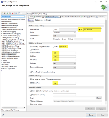

Do not use the 'blue' debug button, use the 'green' one instead. The reason is that the IDE otherwise might change the connection back to a local one.
So:
a) select the project
b) Menu Run > Debug Configurations
c) double click on the left panel on 'GDB SEGGER Interface Debugging'
d) configure to use a remote connection:
From here you can press 'Debug'.
Later on you can use the 'green' drop down to launch it:
I hope this helps,
Erich

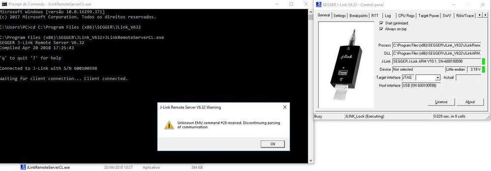

Hi, sorry i'm late, i was busy with another project.
Here's the breakdown: I enabled the option, hit search and it didn't find any SEGGER probes in the network, but okay, i wasn't connected to one.
So i ran "ip 192.168.1.27" (i'm in the same network) in the GDB Commander and as usual, it displayed connected in my PC and in my partner's PC (server).
Again, i hit search in the MCUXpresso, boom, it found my partners SEGGER but with one problem, the IP wasn't correct, it detected an IP address of -1 (Our SEGGERS don't have Ethernet ports, but as implicity mentioned before, it worked on KDS). Anyways,, i tried to hit debug and it didn't work.
So i changed the IP manually to 192.168.1.27 and tried again. In my partners PC (server) it prompted a window saying "Unknown EMU Command #28...")rubenspc.png

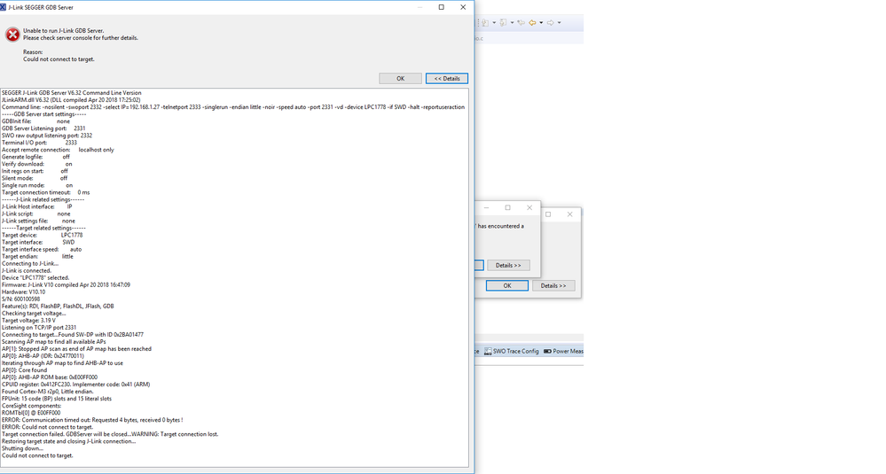

In my side, it displayed the following:

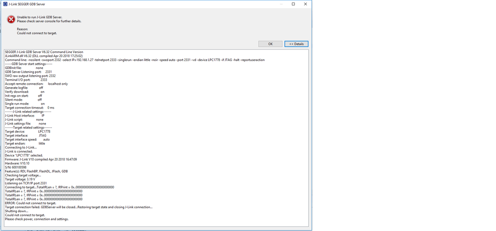

I noticed that SWD was the configured interface in my side (client side), but the hardware interface is actually JTAG, so i switched to JTAG in my side (client side) and tried again.
This time, my partner's PC (server side) didn't get the "Unknown EMU..." and even rebooted our hardware, but in my side (client side), i got the following:
I hope that this is informative enough for you to help me.
