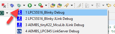

Hi @mzielinski ,
yes, it works for me in 10.3.
Do not use the 'blue' debug button, use the 'green' one instead. The reason is that the IDE otherwise might change the connection back to a local one.
So:
a) select the project
b) Menu Run > Debug Configurations
c) double click on the left panel on 'GDB SEGGER Interface Debugging'
d) configure to use a remote connection:
From here you can press 'Debug'.
Later on you can use the 'green' drop down to launch it:
I hope this helps,
Erich
