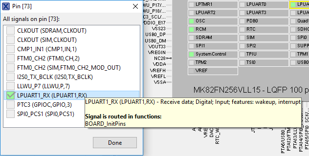

EugeneHiihtaja
Senior Contributor I
Hi Marek !
Yes this is problem. Not all pins have option (n/a, disabled). As result, they can be configured as GPIO pin and Z-state can't be generated if pin available in RoutedPins table.
You can see this pin has dimmed green color and already belong to Board_InitPins group.
And I try to put it to other group for be configured in Z state.

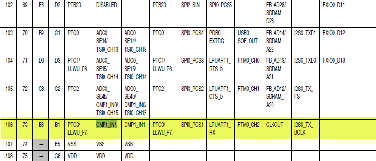

jorge_a_vazquez
Hi Eugene Hiihtaja
For the K82 the analog mode is CMP1_IN1:
/* Configure LPUART1 pins to Z state. */
PORT_SetPinMux(PORTC, 3, kPORT_PinDisabledOrAnalog); // RX
PORT_SetPinMux(PORTC, 4, kPORT_PinDisabledOrAnalog); // TX
So, that mode configuration is the one that you can use.
Jorge Alcala

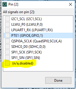

marek-trmac
Hi Eugene,
in Pins tool, open "Pins" view on the left side, and click on first column on the pin you want to configure. Typically each pin is possible to assign to several peripherals, so dialog with peripheral signal appears - see attached screenshot.Capture.PNG
Select check box (n/a,disabled) to configure pin to disabled state (the state is highlighted on the picture above).
Then open "Code Preview" view on the right side and check, whether generated code is what you expect. The code preview is refreshed automatically, so you can easily review each change.
Hope this helps.
Marek
