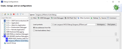

med_engineer
@ErichStyger Thank you for the suggestion!  Your second suggestion to pull the symbols from the AXF file and the application code from the SREC file solved my issue.  Debugging is now completely seamless and works as one would expect.
Just to be clear for anyone else who sees this topic in the future; The steps below are what I had to do in MCUXpresso in order to implement this solution.
  1. Under the “Run” menu select “Debug configurations”
  2. Ensure that you have the correct debug configuration selected in the left-hand pane ("Sargasso_EFDemo JLink Debug” in the screenshots below).
  3. Under the “Main” tab, edit the “C/C++ Application” to use the SREC file using the “Browse” button (see screenshot below).
  4. Under the “Other Symbols” tab, edit the “Load symbols” file to point toward the AXF file using the “File System” button (see screenshot below).
  5. Click “Apply” to apply the new settings.
