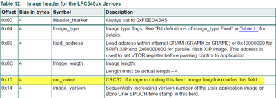

Generate and place CRC checksum to 0x10000170 of LPC54s018 after compile project.
In image header for LPC540xx devices, the offset 0x10 is crc_value, in LPC54s018 , the address is 0x10000170. so we need save CRC checksum value in  this  place.

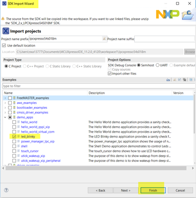

  • Import SDK demo “led_blinky” into MCUXpresso IDE (Just use this demo to demonstrate).

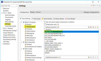

  • Enable Compute CRC, because there is one bit in Image header for LPC540xx,Just add “ADD_CRC” or “ADD_CRC =1”, build project.
Can check from S19 file:
When choose no CRC computation (no defined “ ADD_CRC “ symbol), the data in address 0x0164 bit0 is 1,
When choose compute CRC, the data in address 0x0164 bit0 is 0,

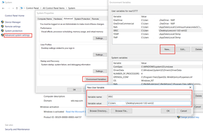

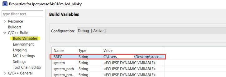

After download, srec_cat.exe is the main program we used.
  • Place srec_cat.exe utility in a common directory (to reuse it even if you change the project or even the MCUXpresso IDE version). Be sure you add that “common directory” in the PATH environment variable, then be sure the eclipse was restarted to “see” the PATH content.
  • Create command file crc_add.txt, and place it under" Debug" folder of project.

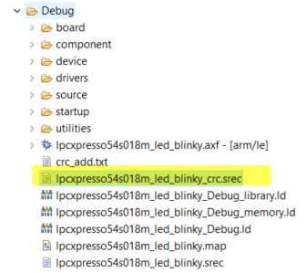

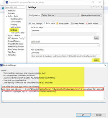

  • Add post-build command to create srecord file with CRC checksum.
arm-none-eabi-objcopy -v -O srec "${BuildArtifactFileName}" "${BuildArtifactFileBaseName}.srec" & srec_cat.exe @CRC_add.txt
7Build project, the .srec with CRC checksum file will under Debug folder:
