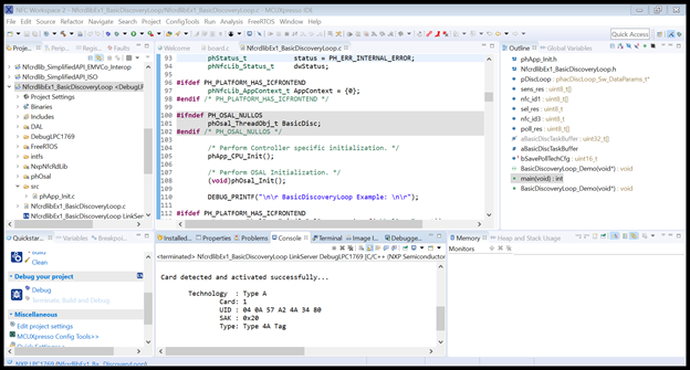

I just start to develop on a PNEV5180B board (PN5180 + LPC1769) and I'm novice in the NCF application.
I tried to debug the NfcrdlibEx1_BasicDiscoveryLoop on the board but I have a warning "Description Resource Path Location Type : cannot find entry symbol ResetISR; defaulting to 00000000 NfcrdlibEx1_BasicDiscoveryLoop C/C++ Problem", I thought it was a startup problem so I started to look at a startup.c but it was missing, I cannot find the cr_startup_lpc175x_6x.c file in the whole library.
I added it manually, the warning is gone from the Problems windows after the build but the debug still doesn't work.

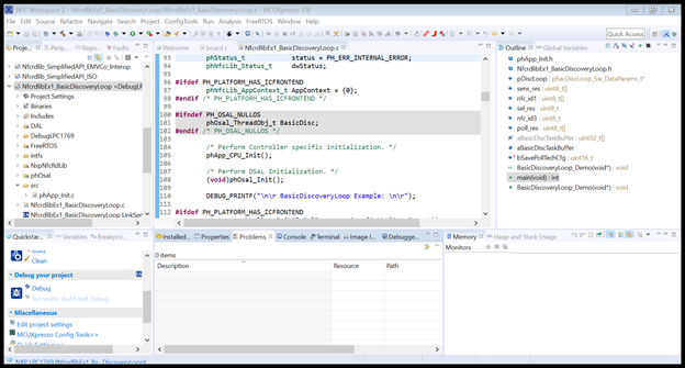

Hello Emma,
I hope you are doing well.
There was a mistake with the library release where the startup file was not included. However, the current version was corrected. I just downloaded the last release and run the Basic Discovery Loop successfully.
As you can see, there are no longer errors or warnings.
Please download again the library. You should not have any problem.
