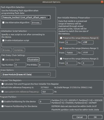

So I tried to edit "Debug configuration" and add a skip memory area in "Debugger->Advanced options->Preserve this range". However, the NVM region is always re-flashed with 0xFF.
How can I skip re-flashing of NVM_region, to keep its content?

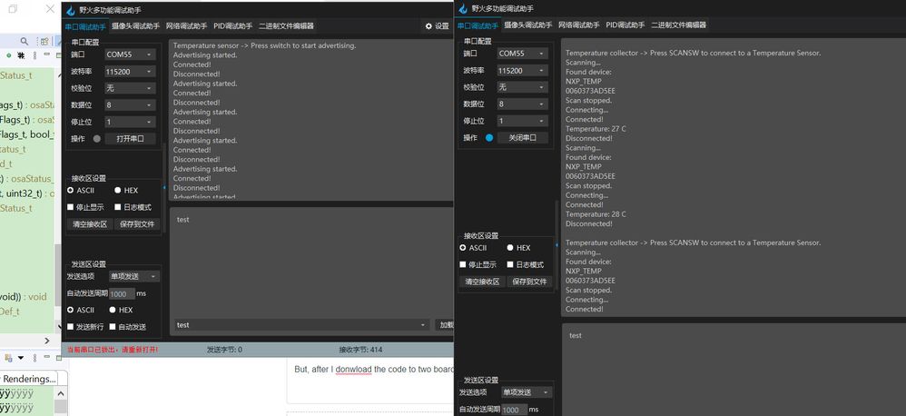

  Today, I checked your issues again, and test the temperature_collector and the temperature_sensor.

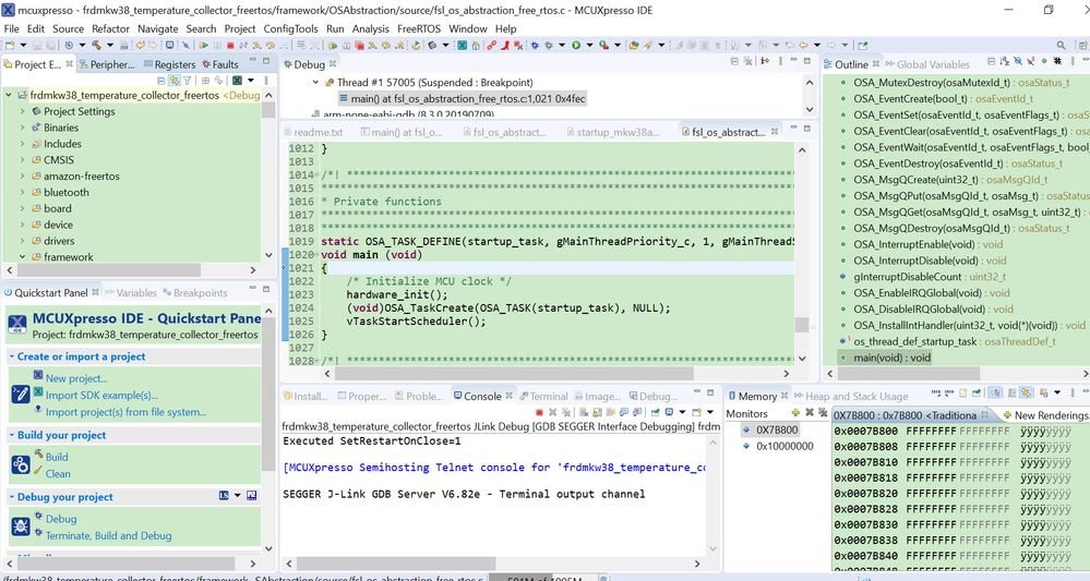

I also debug my temperature_collector, in your mentioned FlexNVM also don't have the data, it all are 0XFF

Could you tell me why you need that flexnvm area, as when I test it directly, even I don't have that area, I still can bond, two boards works OK, one as collector, another as sensor.
This is my test result:
Do you test the SDK two project directly? As I check your mentioned NVM region, no data, I still can make it works.
I think maybe your issue is not caused by this area.
Do you have two NXP FRDM-KW38 board, can you test it again whether it works?
If you already use the FRDM-KW38 board, can you tell me how to reproduce your issues, as I still can realize bond.

Do you just run the SDK project and meet the NVM erased issues? >>> I only added a skip memory region in debugger page from 0x7b800 to 0x7f7ff.

   Please also give me an screen shot about"  I only added a skip memory region in debugger page from 0x7b800 to 0x7f7ff." You means, you want these area don't be erased, and reserve the previous data when downloading the new app, right? But the MCUXPresso also erase this area, right?

You means, you want these area don't be erased, and reserve the previous data when downloading the new app, right? But the MCUXPresso also erase this area, right? >>> I want to preserve the content of this area, so it must be neither erased nor programmed. See the picture below.
