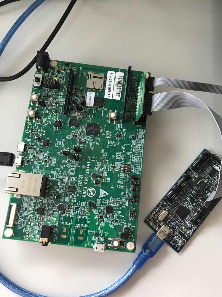

kerryzhou
Hi variable_andrew,
   I test the CMSIS DAP again, and it works, mainly refer to this post:
https://community.nxp.com/t5/MCUXpresso-IDE/Problem-debugging-on-iMX-RT1052-using-LPC-Link2/m-p/8208...
This is my test result with LPC-LINK2 CMSIS-DAP V5.361
Please try it again.
RT1052-EVK:
J29,J32,J33,disconnect
J1 connect 3-4, USB connect to j9
LPC-LINK2, JP1 connect, JP2 connect
Please try it again, any improvement or not?

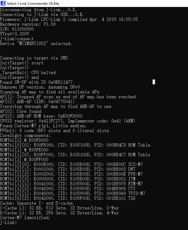

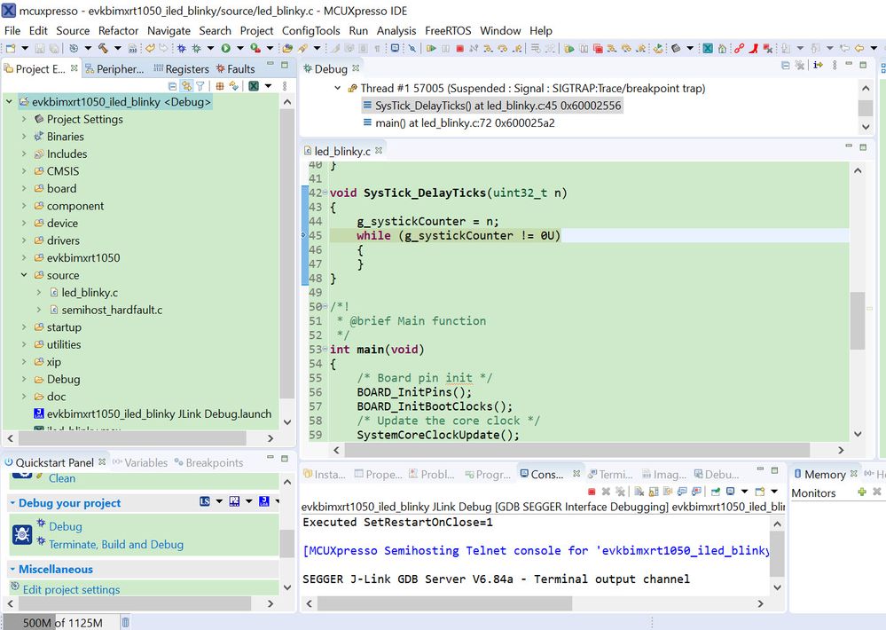

kerryzhou
Hi variable_andrew,
    I highly suggest you try the JLINK on your side.
   You can use the JLINK firmware which still can use the LPCscrypt to download the code:
https://www.nxp.com/design/microcontrollers-developer-resources/lpc-microcontroller-utilities/lpcscr...
  To make sure you are using the latest jlink firmware, you also need to refer to this item in the segger website:
https://www.segger.com/products/debug-probes/j-link/models/other-j-links/lpc-link-2/
  I have tested the LPC-LINK2 JLINK firmware with the MCUXPresso IDE, it works OK.
  This is the JLINK command connection, it can find the ARM core
This is the JLINK MCUXPresso project debug result, it can debug the code:
So, please try the JLINK.

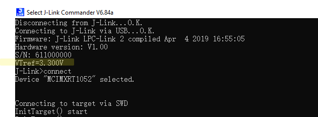

kerryzhou
Hi variable_andrew,
   You need to connect the VDD to the SWD JTAG_VREF pin, this is important.
It used to detect the VTref =3.3V or not, do you have this item, after it has the 3.3v, then it will do the SWD checking.
Please check it at first.
Kerry

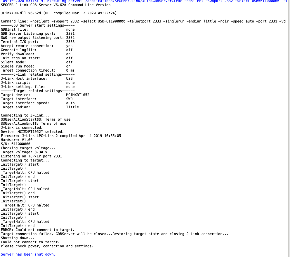

variable_andrew
Senior Contributor I
I have been switching back n forth between JLINK and CMSIS-DAP.
Here is the output from jlink:
Why would it keep getting CPU halted?

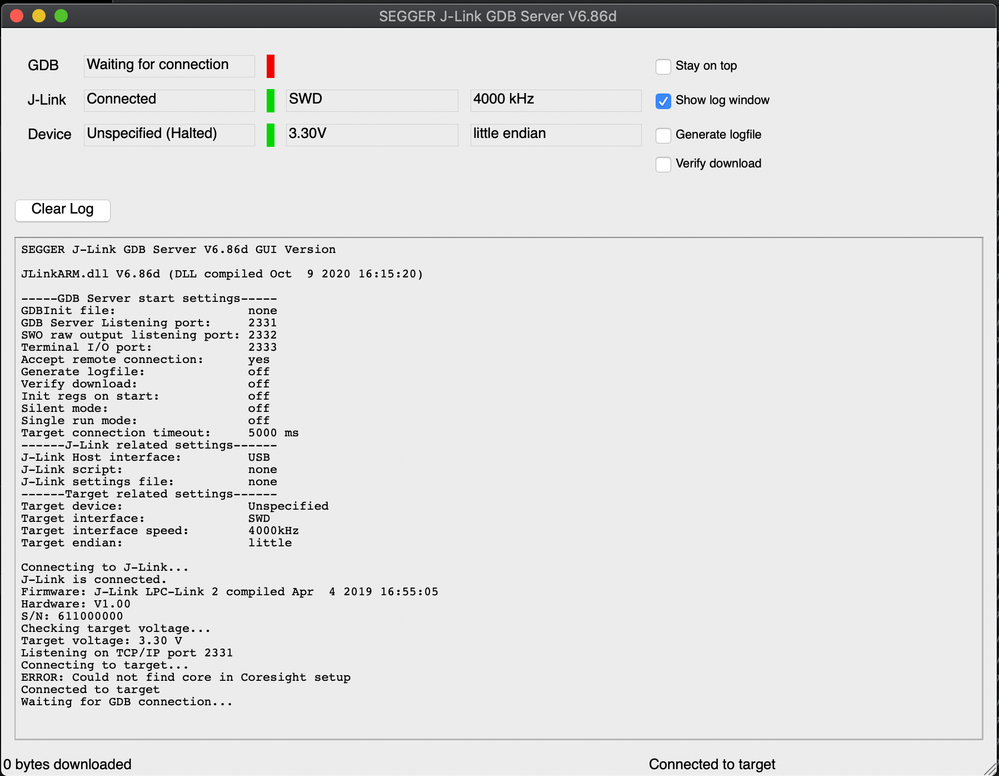

variable_andrew
Hi @kerryzhou ,
Correct, that was from MCUXpresso IDE. I am on MacOS and couldn't find JLINK commander, but I see SEGGER updated their software package last night.
I downloaded these tools andI don't see JLINK commander, but I do see the SEGGER J-Link GDB Server v6.86d:
I was able to connect to a Seeed Arch board last night - just not this board, so it would seem that after lpc-link2 started having issues, it some how brought down this RT1052's JTAG/SWD port.
The odd thing is - everything else still functions (spi, qspi flash, internal ram, sdram, usb, csi, i2c, uart, etc etc etc etc).....
I have never had a board/chip just have SWD/JTAG debug die on it... any ideas what else it might be? Our boot_mode == 01 (inteernal) same as always.
Our device is QSPI FLASH (64MB) and appears to be working fine... we're using the same project we've been using over the past 6 months.
Currently in MCUXPresso 11.2 + the above JLINK, if i try to debug, it appears to downloads code, resets the part, but doesn't break at main - starts running, & prints the expected (to the console):
"USB device CDC virtual com demo" in the console.
If i try to pause the debugger - it fails to set breakpoint and disconnects.
