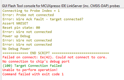

I just tried with the KL25 based sample PCB (with KL25 SDK installed and project created from wizard), and same problem. It is written at the bottom right of the MCUXpresso window in red color: "No connection to chip's debug port".
It indeed looks like the connection between the MCU-link and the sample PCB is not correct.
I will re-check all connections.

Then i added also the 3V3 [VCC] connection between my MCU-link probe and my sample pcb, and i tried again to control the KL25 of the sample pcb via MCUXpresso, but it is still not working.
Here is a screenshot of the error message.

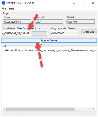

A much easier route is if you have a J-Link connection to the device.
Start the JFlashLite.exe (I assume Windows: it is in C:\Program Files (x86)\SEGGER\JLink) and specify your device:
Then specify your binary file and program it:
done.
