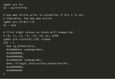

Is it possible to issue gdb commands from MCUXpresso while debugging a hard fault e.g.?
In platformio I could do this eg:
Many thanks in advance

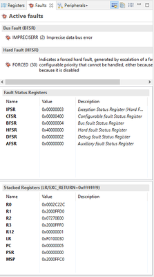

Have you seen the Faults view already?

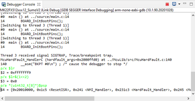

But of course you can execute any gdb commands or scripts too:
