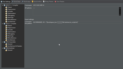

This is still an issue on Windows. The above suggestion of passing a script file to ar is not fully correct, as ar does not accept a file, but commands passed through stdin.
Here is a way to do this. You could use a pre-build script to ensure the ar-script.txt is up to date. This isn't perfect as the powershell script generates absolute paths, but that's an easy fix.

First of all, open the Project Properties for your library project, and open the Archiver settings:
What you can then do is replace the use of ${INPUTS} in the "Command Line Pattern" option, which is where the list of filenames effectively gets poked in, with a wildcard definition of your object files.
In your example, all of your objects appear to be contained in a directory called "source". So delete ${INPUTS} and replace it with ./source/*.o :
Then Apply and Close.

I think the best way to do this (without splitting the project) is to use a AR script file. You will need to create the script file manually but then you can invoke using
ar -M script.file
see ar scripts (GNU Binary Utilities)

scottlarson
Ok, I made an ar script. Works for now. Thanks!
