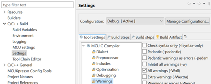

Could you please try out enabling All Warnings (-Wall) directive in Properties -> C/C++ Build -> Settings -> MCU C Compiler -> Warnings? Which optimization level and dialect are you using?
[MCUXpresso IDE Properties]
Also, if possible, could you please share a demo code with static void __attribute__((constructor)) fipsEntry(void); entry to show me the issue?
