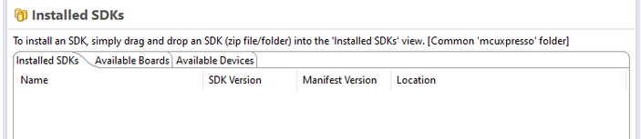

I have run the installation program for MCUXpresso version 11.2.1 as administrator.
I have launched the MCUXpresso with administrator privileges.
I got the next messages in the log:
I have gone to the "Install New Plugin SDK" window, and I have installed the package for micro LCP54606J256. Once the installation finishes, it says that micro is installed
But when I go to the Installed SDKs view, nothing appears.
fernando_casado_1-1696934931576.pngThe log shows the next errors:
I have pressed the "Recreate and reload part support info" button, but nothing happens.
I have restarted the MCUXpresso (again as administrator) but nothing happens.
I have repeated the process for microcontroll LPC5502 with similar results: nothing shown in the Installed SDKs view.
Any help?

Hello @fernando_casado,
If possible, could you please change to the newest MCUXpresso IDE v11.8.0?
Is the same issue happening there?
Best regards, Raul.

fernando_casado
Yes, after getting crazy for two days, on Wednesday I updated to the latest MCUXpresso version and the problem disappeared. It seems it is a bug related to version  11.2.1
