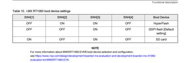

I connect board in Debug mode via micro USB (mimxrt1060-evkb). I want to run demo app. I see the documentation of tflm_cifar10 and it said that
Prepare the Demo
1. Connect a USB cable between the host PC and the OpenSDA USB port on the target board.
2. Open a serial terminal with the following settings:
- 115200 baud rate
- 8 data bits
- No parity
- One stop bit
- No flow control
3. Download the program to the target board.
4. Either press the reset button on your board or launch the debugger in your IDE to begin running the demo.
It does not mention about mode. What mode do I need to set? I dont remember, but it is SW7: OFF, OFF, ON, OFF (0010). Is that right?

Alex_Wang
Hi, @nnxxpp
You can refer to the user manual, we can choose the appropriate way to start, as follows:
You can refer to the attached file for details.
Hope this helps you.
Best regards, Alex

nnxxpp
@Alex_Wang
May be I saw tutorial for MIMXRT1060-EVK, this tutorial mentioned about SW7. It is used SW7 to set up boot mode. Getting Started with the MIMXRT1060-EVK | NXP Semiconductors
Sure, thank you. For MIMXRT1060-EVKB, we need to use SW4.

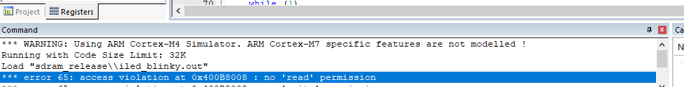

nnxxpp
@Alex_Wang
I followed your guide, But when debugging with simulator, I got an error related with "write" permission as the following.
*** WARNING: Using ARM Cortex-M4 Simulator. ARM Cortex-M7 specific features are not modelled !
Running with Code Size Limit: 32K
Load "ram_0x1400_release\\hello_world.out"
*** error 65: access violation at 0xFFFFFFF4 : no 'write' permission
I created .ini file to fix it Access violation at 0xFFFFFFF4 - Keil forum - Support forums - Arm Community, but it does not work.
Do you have any recommendation for me? Thanks.

Alex_Wang
Hi, @nnxxpp
First, Check whether the chip pack is correctly installed in the device. It will be displayed in green after installation:
Second, Check whether the MDK project is decompressed correctly
There are no problems on my PC as follows:
Best regards, Alex

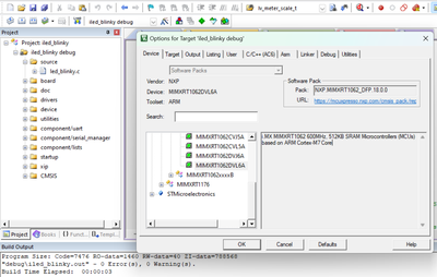

nnxxpp
@Alex_Wang
It seems that you also had an error with emulator. In the picture 2 error, , there is an with access violation.
I set up for board MIMXRT1060-EVKB with mounted device MIMXRT1062DVL6B. I installed BSP and NXP.MIMXRT1062_DFP.18.0.0.pack. I run with Hello world project, but simulator did not work. Here is my set up.
I also had error 65, but with "write" permission in Simulator mode.

nnxxpp
@Alex_Wang
I also tested iled_blinky with simulator. There was an error with read permissions "*** error 65: access violation at 0x400B8008 : no 'read' permission". It is same your error.

Alex_Wang
Hi, @nnxxpp
You can refer to the following methods:
1. Create an.ini file with the following contents:
You can include the wrong address. You can include the error address, on my PC error address 0x40000000-0x401FFFFF.
2. Load the ini file to the initialization file:
Best regards, Alex

nnxxpp
@Alex_Wang
I tried it and informed you yesterday as follow
@Alex_Wang
Createing .ini file did not solve the problem. Did you test it?
