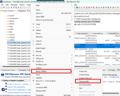

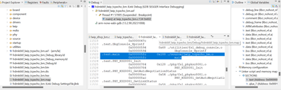

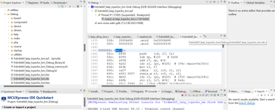

Celeste_Liu
Hello @ChristofAbt ,
Thanks for your post. We don't have Ozone on our side, so I'm unable to replicate your issue in the exactly same way. I used the on-board debugger to debug the axf file generated by MCUXPresso and didn't encounter any problems.
In the .map file:
.text.main 0x000005fc 0x188 ./source/lwip_tcpecho_bm.o
0x000005fc main
Through the disassembly in the following way.
You can see from the following picture that there is no problem.
You mentioned that your ELF file was generated by MCUXpresso. Could you please tell me how exactly you generated it?
BRs,
Celeste
