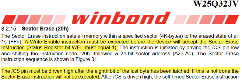

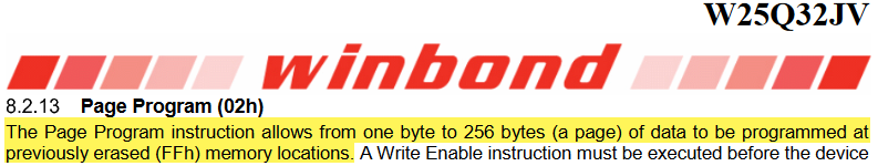

Thanks for the information! Please notice the following statement from the datasheet of the memory that you are using.
Before writing on the memory, you need to erase the section in which you want to write. So, if you already confirmed that you are writing even you are not erasing, you are overstressing the memory. Don't write anymore in the memory until you are able to erase first.
Did you consider the next two things that are mentioned in the datasheet?
Victor.
