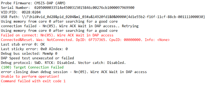

We recently noticed issues using GUI Flash Tool inside MCUXpresso while running in Windows10 (also reported by several customer).
The operation fails with error "Nn(05). Wire ACK Wait in DAP access".
Below is the complete error log:
However it is possible, in the same conditions, to flash using the Debug function.
On some laptops the issue is 100% reproducible while on some others it is only observed when the CMSIS-DAP probe (on-board or LPC-Link2) is connected behind an USB hub.
Jeremy.

Jeremy - we will contact you directly to obtain more information.
