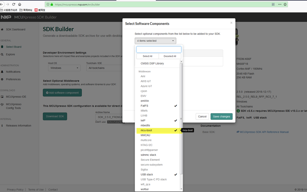

   Please refer to this project:
Use SDK_2.5.0\boards\frdmk66f\bootloader_examples\freedom_bootloader
 Please update the IDE to the new version.
If you still have the problem, please also give me the error picture, and tell me your IDE version.

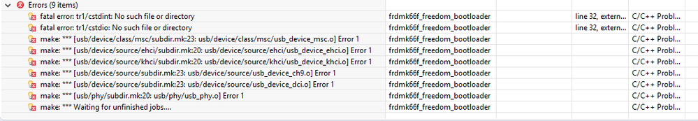

curtis_robertso
I am using the SDK 2.5 and IDE 10.3.1.  The errors I get are below.

kerryzhou
Hi Curtis Robertson,
   Please refer to this SDK doc:
KSDK_2.0.0\SDK_2.5.0_FRDM-K66F\docs\Getting Started with MCUXpresso SDK.pdf
Chapter 3 Run a demo using MCUXpresso IDE
You need to : Drag and drop the SDK zip file into the “Installed SDKs” view to install an SDK.
Do you do this operation before your build and import the frdmk66f_feedom_bootloader project?
  This is my build result:
No errors.
Please refer to the doc, and import build the project again.
kerry
