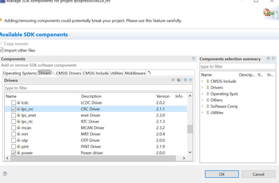

I am just getting started with MCUXpresso.  I am creating a new project in MCUXpresso and need to add the Flash and CRC SDK components for internal flash and CRC.  At the "Configure the project" step, there is a Components section "Add or remove SDK software components".  I can not find the Flash or CRC SDK components in any of the 11 tabs.  Am I looking in the wrong place?

I can find CRC and Flash Iap driver in a LPC device SDK but I don't know what's your chip part number?
