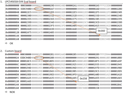

After one week of investigating, I found the reason for my problem. Maybe I´ll help somebody...
The XIP image layout  was incorrect. The HEADER_OFFSET at 0x28 shall point to the HEADER_MARKER with i typical standard value of 0x160. But in my case I had to change it to 0x158.
After that the image could be loaded.
Ron

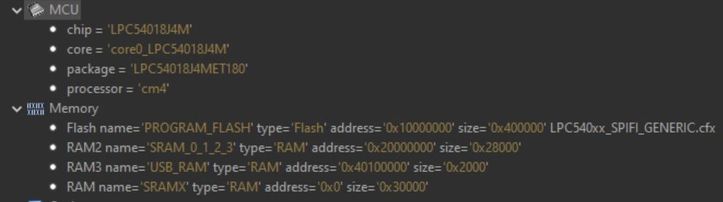

2,755 Views
ronwal
Hello Alice
Yes I know it´s setup like this. My problem is, that the program does not load at all when configured for XIP. It hangs before start.
Is there any special configuration I have to make to the internal QSPI flash before able to use it?
My memory config is as follows and I am using the LPC540xx_SPIFI_GENERIC.cfx driver:
Also I checked my linker file if configured correctly:
  • Image type 3 (XIP with no CRC)
  • Load_address 0x10000000 (flash)
Also I checked for a possible ISP boot mode
  • the BOOT_SRC bits9+10 are not set, which means the ISP pins decide
  •  P0.4, P0.5, P0.6 have external pullups and always high, which means Auto boot sequence
My program ist based on the "hello_world_qspi_xip" SDK sample. But I also tried to create i new project from scratch, which shows the same behaviour.
Do you have any other idea I could check?
Ron
