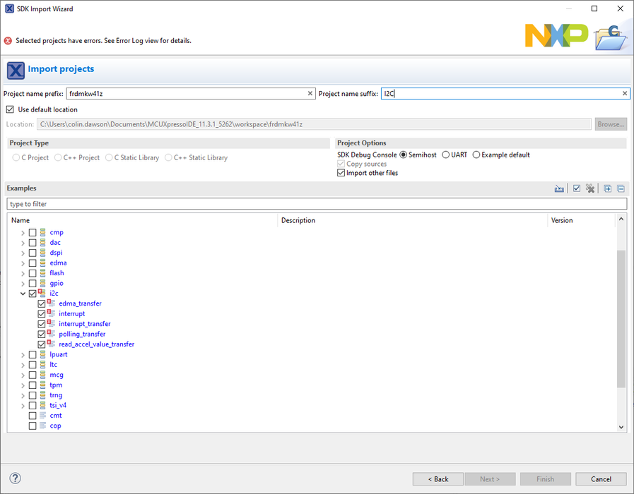

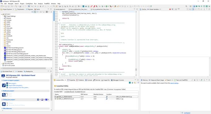

Hello!  I hope you day is going well.  I appreciate the help.  Can you tell how to get the frdmkw41z SDK examples into MCUXpresso?
I have this:
3,786 Views
c_dawg
I found my problem.  I didn't have a check mark next to the SDK_2x_FRDM-KW41Z at the bottom middle:
The SDK_2.x_MKW41z512xxx4 doesn't have the same examples...

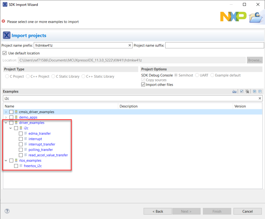

Hope you are doing well. The Serial Manager is one of the Framework Services Provided by the Connectivity Framework software. You can use it to communicate with multiple serial interfaces and works with the connectivity stacks.
For more information, please check section 9 of the "Connectivity Framework Reference Manual.pdf" (Path: SDK_FRDM-KW41Z_doc.zip\docs\wireless\Common). Also, this Community post might be helpful: Enable I2C Serial Interface in Bluetooth KW41Z Heart Rate Sensor Demo Application.
And there is only one address to be used for I2C (gSerialMgrIICAddress_c).
The link you shared, corresponds to the SDK API. You can import the driver examples from the SDK:
