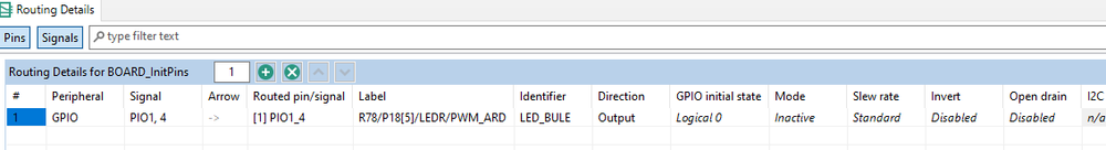

I was under the impression that the Config Tools, especially the Pins Tool, would create code that is usable in my own code in a reasonable way.
Turns out, I was wrong. The code created is just for initializing pins configuration. It can not be used to access or control the pins or at least reference the pins.
The config tool's generated code is a disaster.
For example if a project needs to control a LED, a GPIO is configured as output and assigned an identifier with a descriptive name. The routing information in the tool will look like this (example "led_blinky" from LPC5526 SDK, typos retained):
The generated code in pin_mux.c defines only this variable:
gpio_pin_config_t LED_BULE_config = {
        .pinDirection = kGPIO_DigitalOutput,
        .outputLogic = 0U
That is not enough information to control the GPIO.

I agree that it's not very straightforward and the the code in the led_blinky example is a little bit overcomplicated. But, the board.h and main routine content is not generated by the config tools and you don't have to use it this way.
The single write to a pin can be just :
GPIO_PinWrite(BOARD_LED_BLUE_GPIO, BOARD_LED_BLUE_GPIO_PORT, BOARD_LED_BLUE_GPIO_PIN, 1);
Where LED_BLUE is the identifier you can put in the routing table. Expecting that you include pin_mux.h in your source module.
I agree that it would be in many cases easier having some structure holding the parameters, but as far as I know, the GPIO driver aimed to maximize the performance and effectivity of execution avoiding any additional operation.
If you would like to simplify usage, you can define the following macro using macro concatenation to access the pin properties:
#define pinWrite(id, value) (GPIO_pinWrite(id##_GPIO,id##_PORT, id##_PIN, value))
Then in the code you can just use it like this:
pinWrite(BOARD_LED_BLUE, 1);
Additional note: The BOARD_ prefix can be customized if you'd be interested. It's in the functional group properties (Accessible using menu Pins > Functional groups or via the icon on the toolbar).
