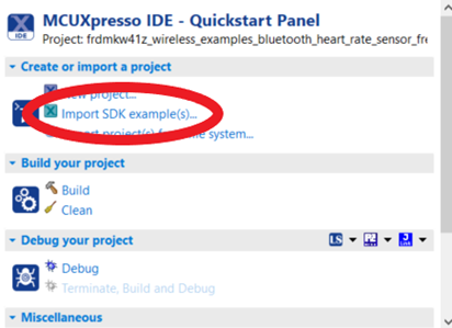

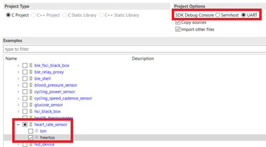

1. Import the FreeRTOS version of the “heart_rate_sensor” example included in the KW41Z’s SDK.
Note: Be sure to select UART as your debug console.

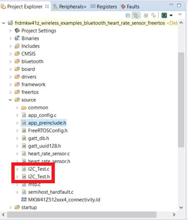

3. Create the new header and source files to which you will add your I2C related functions. For this example, we will name the files I2C_Test.h and I2C_Test.c, respectively.

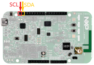

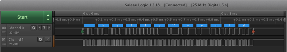

To see the output by using a logic analyzer, and if you’re using I2C1 as your Serial Manager instance, connect the SDA line to J2 pin 9, and the SCL  line to J2 pin 10.
Note: Also connect a GND line from the board to your logic analyzer, you can use J2 pin 7 as your GND connection.
When pressing SW3, you should see the following output:

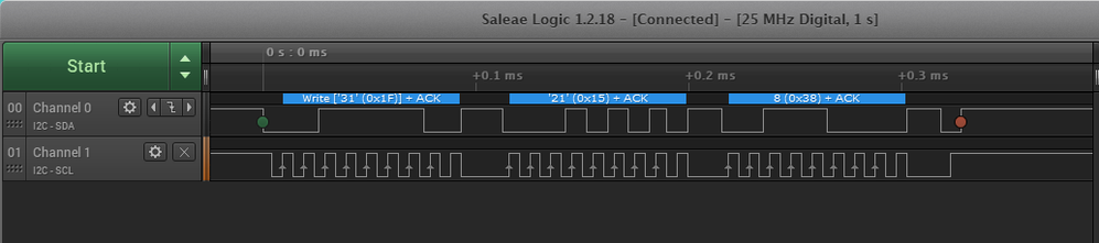

  • We will change the value for one of the sensor's internal registers. We will write a 0x38 to the Freefall/Motion configuration register so that we can detect freefall and motion on the X, Y, and Z axes, so the new payload will have to contain the address for the internal register (which, according to the sensor's datasheet, is 0x15), and the new configuration value, which will be 0x38. The new payload should look like this:
uint8_t test_data [] = {0x15,0x38};‍‍‍‍‍‍‍‍
  • When sending the payload, this time we should get an acknowledge bit coming from the sensor, so the data transmission should look something like this:
The sensor is sending the ACK bit accordingly, and the data is being written to the sensor's specified register.
