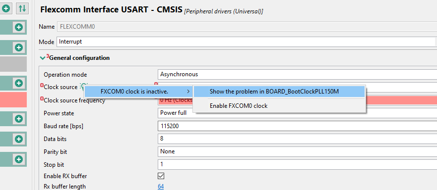

Next I use Peripherals Tool to configure Flexcom0 as USART (CMSIS universal drivers). When I add this interface, the configuration page correctly indicates an error: "clock source is not configured". It also give me a quick hint with the possibility to enable FXCOM0 clock:
I select "Enable FXCOM0 clock" and then the error indicator disappears.
I click on "update code". This closes the Peripherals window and returns me to the Develop view.

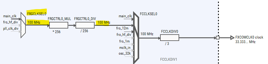

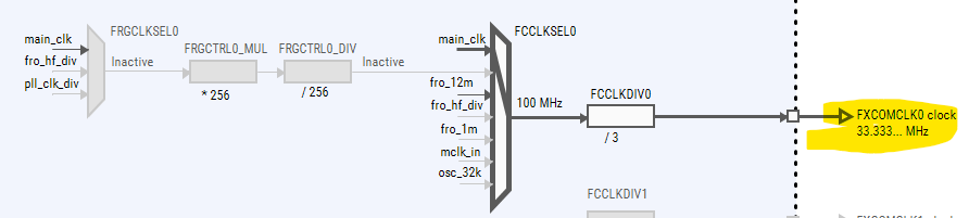

Now I open Clocks Tool in order to change the clock routing for FXCOM0 clock.

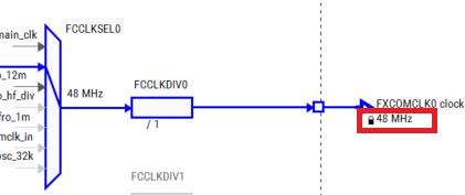

You can see that "FXCOMCLK0" clock is enabled:
There, I change FCCCLKSEL0 from "main_clk" to "system_pll_divided_clock. This disables FXCOMCLK0.

Again, I now use the "quick fix" from before to make the Peripherals tool enable the clock for me.

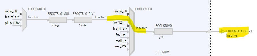

I open Clocks Tool and find that some components along the clock route are now enabeld that were disabled before:
As before, I don't want to use the clock route to "main_clk" but instead to "pll_clk_div".
When switching to "pll_clk_div", FXCOMCLK0 gets disabled again. Arrrgghh.

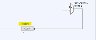

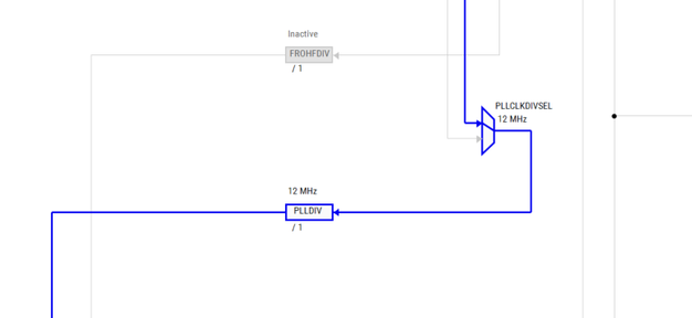

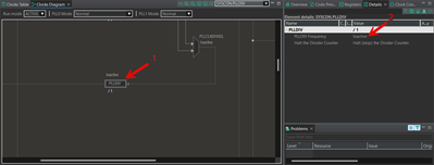

So I route the clock starting at the oscillator. This works until I hit PLLDIV.

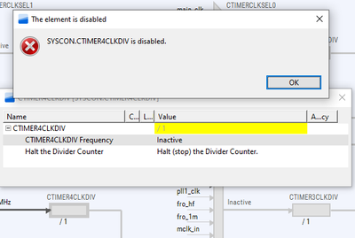

This element is disabled and I have no idea how to enable it. I try double clicking it, the name, the divider, the "inactive" text but to no avail.

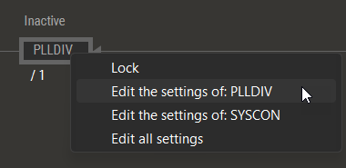

I finally right clicked the element and selected "Edit the setting of: PLLDIV". There, I try to enter a "PLLDIV Frequency" but I'm only greeted with an error window popping up claming that the element is disabled. Desperate, I clicked on "Halt the divider counter" and selected "enable the divider counter".
Can you believe it, this enabled the route. 🤷‍

Thank you, @EdwinHz, for you reply. I understand that the "quick fix" cannot know which clock source I want to use. That is therefore not my main gripe.
My main gripe is about enabling a clock divider, for example PLLDIV:
I could not find a way to enable it on the clocks diagram with the mouse. That was  a frustrating experience.
Is there a way to enable it by operating with the mouse on it?
If not, I suggest to add one.

EdwinHz
Hi @danielholala,
When clicking on any of these divider blocks, you will see that the "Details" window on the right will change to reflect the possible changes of that block. Therefore, the editing process is to click the block, and then enable it by setting a frequency on the "Details" window:
Also, you can right click the block and select "Edit the settings of: PLLDIV" in this case, like you mentioned before on your post. This way, a pop-up window will appear with all of the same setting as the Detail window from before:

Dear @EdwinHz ,
you suggest to enter a frequency to enable a divider. That would be intuitive, I agree.
I tried this but it does not work for me. If I enter a frequency, I a warning window pops up telling me that the divider is disabled, see screenshot:
I think it would be intuitive to enable the divider when I enter a frequency or modify the divider value (e.g., by just clicking below the element on the text "/1").
I hope that the Config Tools team will address this issue in an future update.

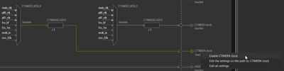

EdwinHz
Hi @danielholala,
In that specific case, you need to enable CTIMER4 clock first in order to modify the value of CTIMER4CLKDIV:
Considering that the output of the divider is directly the CTIMER4 clock, perhaps it should also enable it from the configuration of the CTIMER4CLKDIV, as you mention. I will pass this request to the ConfigTools team so they can evaluate its implementation.

danielholala
Senior Contributor II
Dear EdwinHz, Thank you for getting back to me.
Do you have a different Clocks tool version than me? I cannot enable CTIMER4 clock with the CTIMER4CLKDIV disabled. And that makes sense to me.  I think it's good practice to route clocks from the source (oscillator) to the destination component (e.g, CTIMER4 clock). In the big picture, from left to right.
I am convinced that the user experience can be clearly and critically improved when a clock divider gets enabled automatically as soon as I select a frequency for it or change the divider value in the "Clocks diagram".

marek_neuzil
Hello @danielholala ,

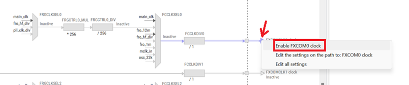

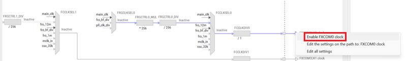

I have checked your use case and the issues you have reported. The Enable FXCOM0 clock functionality that is provided in Peripherals tool is just shortcut for Clocks tool. The Clocks tool provides the same functionality for each top level output in the clock diagram:
Your use-case can be processed in the Clocks tool without switching the tools. The context menu of each top level output contains the Enable command. This functionality just makes the clock enabled by enabling clock gates, dividers, and other elements on the clock path. Your specific requirements must be processed by manual selection of the clock sources and selection of the PLL mode, configuration of the external clock sources (external clocks sources/crystals must also be specified manually according to connection of the board).
For example, in the case you want to use Enable FXCOM0 clock command you can do it this way:
When the main_clk of the FCCLKSEL0 is selected, select the system PLL divided clock and click on the Enable FXCOM0 clock.
Then the main_clk is selected (because this is the only active clock source of the FRGCLKSEL0) and you must select the pll_clk_div as you want to use the PLL output.

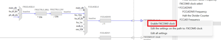

When you process the Enable FXCOM0 clock command again, see below:
The PLLDIV divider is enabled:

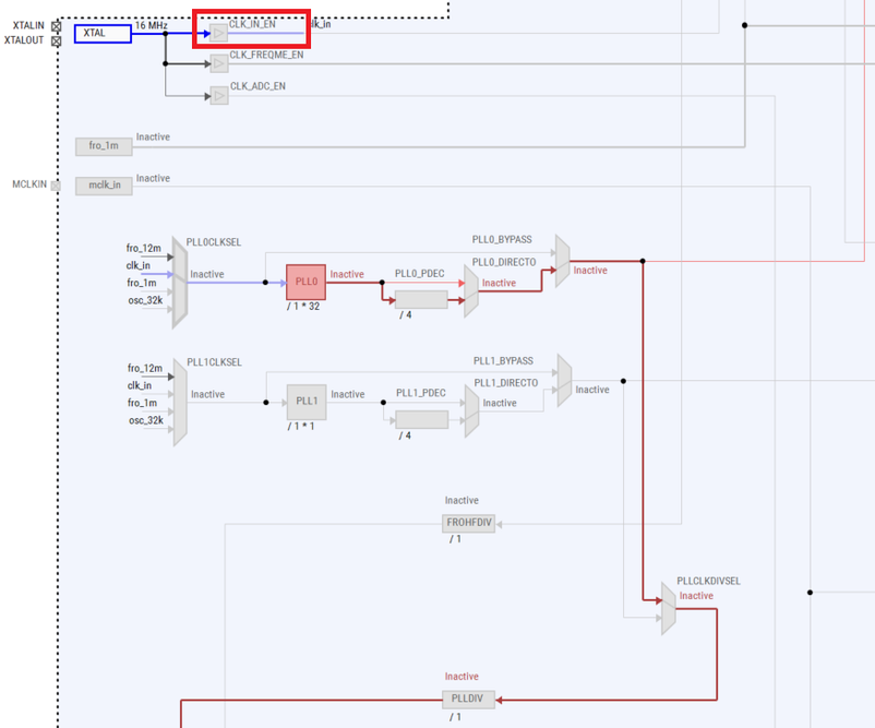

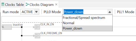

Please note, that the PLL itself is not used, the PLL is bypassed because the PLL is not configured. It provides two functional modes and other settings that must be specified.

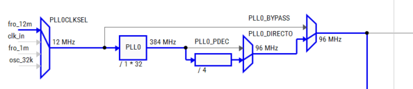

When you for example select the Normal mode the PLL is enabled and 384 MHz frequency is set.

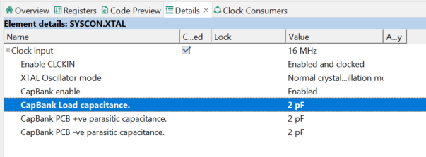

If the board use a crystal, for example 16 MHz, you must set it including capacitors and mode of operation in the XTAL clock source Details settings:
You can select the external clock source and source clock for the PLL:

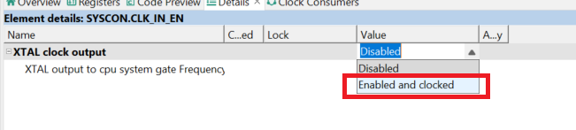

A clock gate is disabled so you can enable it manually in the Details view setting (click on the element).
Select the Enabled and clocked value:

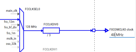

You can also specify the output frequency in the clock diagram:
And the clock tool selects possible clock dividers and provide the settings to satisfy the requirement:
The selection of the required frequency cause also the lock of the frequency output (the lock icon in the diagram near to the frequency).

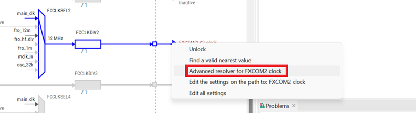

If you require a frequency that cannot be achieved using existing clock path (for example 30 MHz of the FXCOMCLK2) the Advance resolver for the FXCOM2 clock can be used:
It provides more complex analysis of the possible clock paths and try to find a possible solution for all requirements and locked settings. In this case it change settings of the main clock and PLL frequency:
