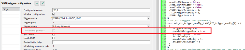

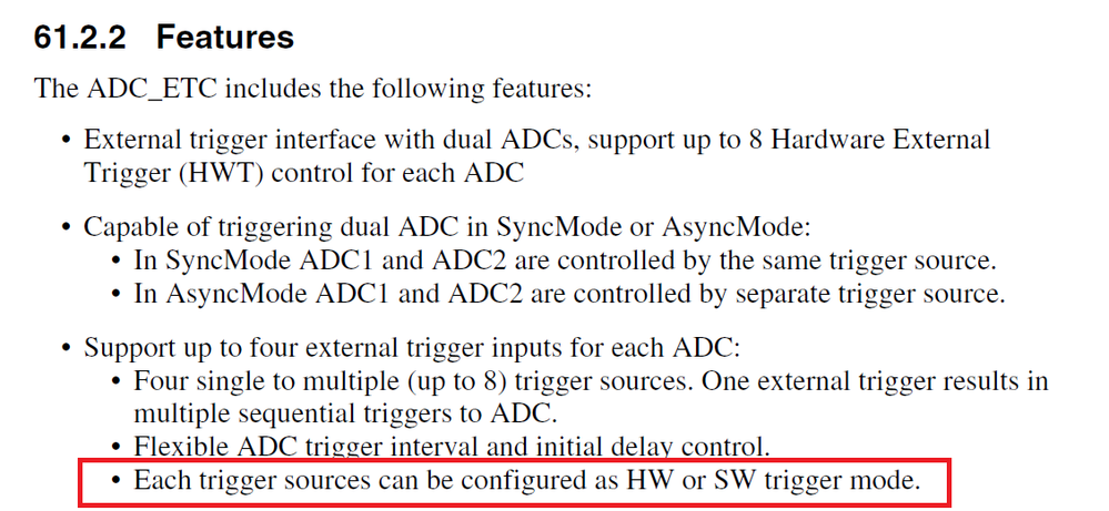

ADC_ETC SW and HW Trigger Mode
the reference manual of RT1020 states in the ADC-ETC Features list (61.2.2 in my version of the manual) that every trigger source can be configured as HW or SW trigger mode.
Additionally every TRIGx_CTRL register has the field TRIG_MODE which specifies HW or SW trigger mode.

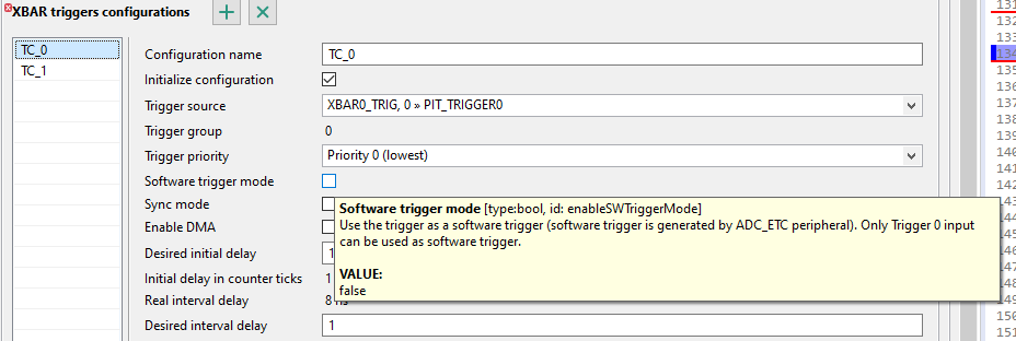

In MCUXpresso Config Tools v7 > peripheral tool the help text states that only Trigger 0 can be used as software trigger
If I select the Software trigger mode and then switch the Trigger source to XBAR0_Trig,1 the checkbox will be greyed out and I can not change the Software trigger mode but it will keep the setting for it (from the selection before switching to XBAR0_Trig,1). The setting will also be set in the generated source code.
Is the reference manual correct and every Trigger source can be used as Software Trigger or is the setting in MCUXpresso Config Tools correct and only XBAR0_TRIG 0 can be used as Software Trigger?

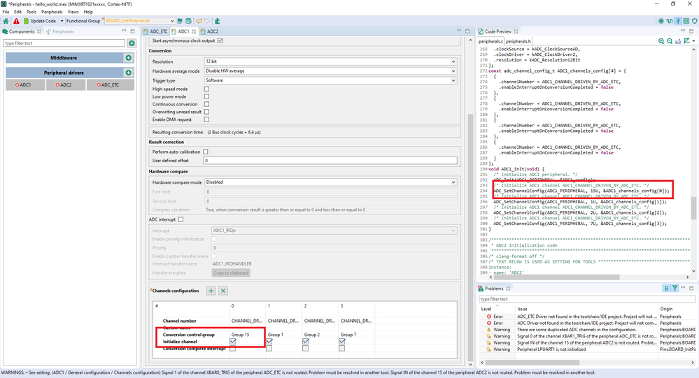

ADC_ETC and ADC peripheral Conversion control group
It is possible to select Group 0 to Group 15 in the ADC peripheral driver but the RT1020 only has 8 registers per ADC.
If I select the ADC1 peripheral driver and a Conversion control group 15 the generated code includes the line
ADC_SetChannelConfig(ADC1_PERIPHERAL, 15U, &ADC1_channels_config[0]);
and this method tests the second parameter with
assert(channelGroup < FSL_FEATURE_ADC_CONVERSION_CONTROL_COUNT);
where the macro is defined as
#define FSL_FEATURE_ADC_CONVERSION_CONTROL_COUNT (8)

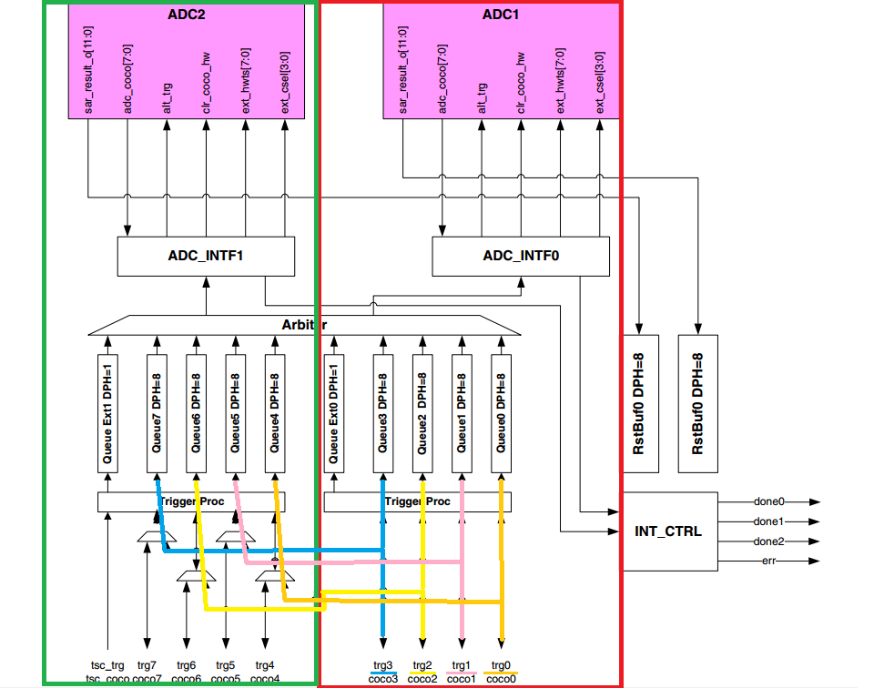

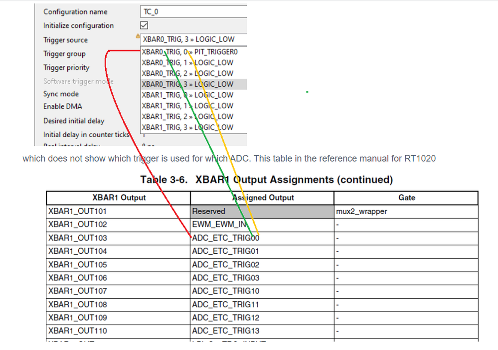

For the ADC_ETC peripheral I'm not sure how the value from HWTSx gets translated to the ADC registers. This overview
looks like every trigger input (trg0 to trg7) can be used for either ADC1 or ADC2 because of the Arbiter - Is that true? To which ADC does the TRIG0_CHAIN_1_0 register belong? And to which ADCx_HCn register does a HWTS0 value of 15 belong?

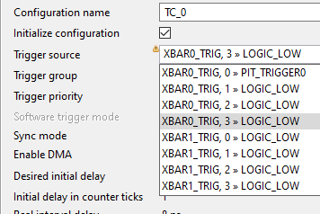

In the peripherals tool i can choose these trigger sources
which does not show which trigger is used for which ADC. This table in the reference manual for RT1020
shows that all ADC_ETC Trigger inputs are connected to the XBAR1 peripheral. Why are they named XBAR0 and XBAR1 in MCUXpresso Config Tools?

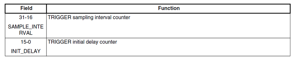

The boxes "Desired initial delay" and "Desired interval delay"
have to be set to at least 1 tick. The reference manual entry to ETC_TRIG0 Counter Register does not mention that the counter has to be set at least to 1 tick.
My question got answered and it is allowed to be 0.
Additional info: The text "Real interval delay" is used for the "Desired initial delay" settings and I think it should be "Real initial delay".

1) You're right about SW trigger it can be selected on all 8 triggers.
2) About ADC conversion control group max number - I don't know whether the feature was available when the component was created, but you are right, the limit should be taken from it.
3) About interconnection of the ADC_ETC:
In the scheme above you can see how I understand it: there are two ADC interface (ADC_INTF0 and ADC_INTF1) which divide whole ADC_ETC into two parts (red and green rectangle).
So e.g.: ADC_INTF0: communicates with ADC1 and its input XBAR triggers are trg0,  trg1, trg2,  trg3 only.
             ADC_INTF1: communicates with ADC2 and its input XBAR triggers are trg4,  trg5, trg6,  trg7 only.
            Exception is SYNC mode that I colored in the scheme at the bottom part in this case trg0 also triggers queue 4, trg1- queue 5, trg2 - queue 6 and trg3 queue 7.
4) Arbiter is there to manage the priority of the triggers.
5) TRIG0_CHAIN_1_0 register is connected to the ADC1 only and means that the source is trg0 and this register has two first queue (chain) items 0 and 1 settings (from 1_0 in register name).
6) Maximum index of ADCx_HCn register is 7 in e.g. RT1050 and so as well HWTS0 = 7 is the maximum value.

7) Relation of the ADC_ETC signals and XBAR signals in RM:
In the ADC ETC as I said before are two parts ADC_INTF0 and 1.
They have XBAR inputs as triggers. The name of the signal visible in the Pinks tool and also in the ADC_ETC component selection "Trigger source" e.g. XBAR0_TRIG, 3 can be decoded: as XBAR - trigger from XBAR (not from e.g. TSC) 0 - relates to INTF0, TRIG, 3 - trg3.
And this is in the XBAR1 Output Assignments table above = ADC_ETC_TRIG03 (0 and 3 are tuples as we as e.g. 12 is 1 and 2 not twelve) - means 0 - INTF0  and 3 trg3.

9) OK, "Desired initial delay" value can be 0.
But for the Interval it doesn't make sense to start next conversion in chain without delay, it can only abort previous undone conversion or leads into the error interrupt.

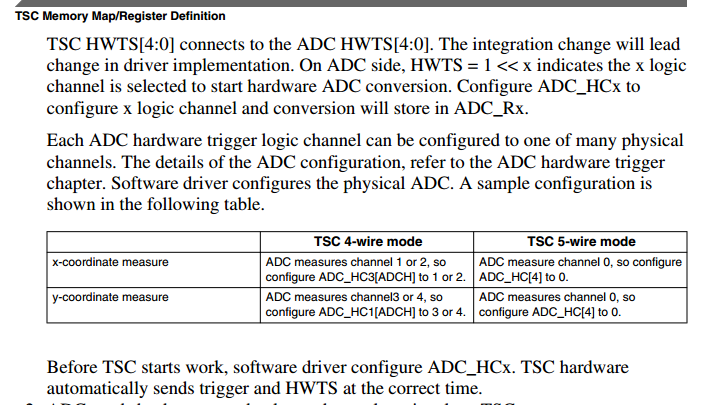

Also I think it would be a good idea to mention the correct values for the HWTS register in the reference manual (RT1020)
instead of referencing the ADC chapter. I can't find a place in the ADC chapter where it is described that a value of HWTS = 1 will select the ADCx_HC0 register.

I found this in chapter TSC for better understanding of the HWTS coding:
Now HWTS signal is more clear:
TSC HWTS[4:0] connects to the ADC HWTS[4:0]. The integration change will lead
change in driver implementation. On ADC side, HWTS = 1 << x indicates the x logic
channel is selected to start hardware ADC conversion. Configure ADC_HCx to
configure x logic channel and conversion will store in ADC_Rx
Logic channel of ADC means the appropriate tuple ADC_HCx and ADC_Rx.
Hope it can helps you also.
Jiri

1) Is the reference manual correct and every Trigger source can be used as Software Trigger or is the setting in MCUXpresso Config Tools correct and only XBAR0_TRIG 0 can be used as Software Trigger?
-- In general, the reference manual is more reliable than the MCUXpresso Config Tools.
-- Please check the below figure.
2) According to RM, every four external trigger inputs are assigned to each ADC, however, ADC1 and ADC2 are controlled by the same trigger source after enabling Sync Mode.
