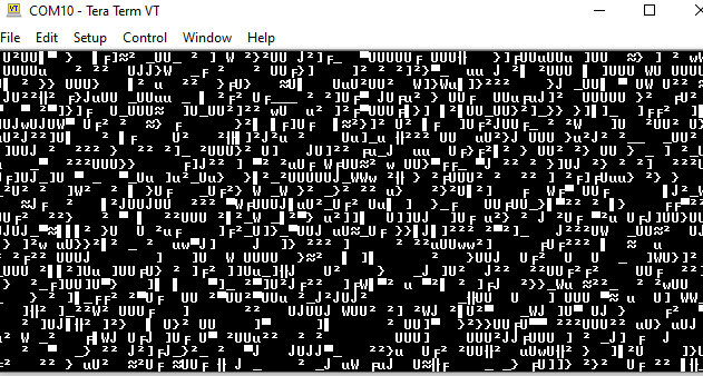

A different but somewhat related question I have now is after putting my program in the bootloader, I noticed that the uart interrupt no longer work correctly.
I'm receiving nonsense on my UART0 communication port. I tested out with the example program in the SDK (frdmkl25z_driver_examples_uart_interrupt) and the same thing is happening. Any ideas what is causing this?
Edit: I forgot to include but if either JTAG or USB port is connected then the UART behaves correctly but if they are both disconnected then I run into this problem.

Nevermind, I was just missing a common ground on the UART cable. Always check the hardware!
