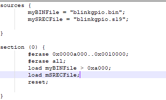

Sorry about the late reply. I was able to port the project to KL25 and got the bootloader to enumerate as an MSD device now. Then I follow this guide right here to create an sb file to drop on to the MSD device.
USB MSD Bootloader Implementation
However, my console display this error when I dropped the file onto the device.
I look it up and found out that this error is a protection memory error so I'm wondering if there's extra command I need to issue in my .bd file.

So I found out that this problem is due to my bootloader exceed 0xa000 in size and I have to move the address of the application in the memory to 0x10000. I no longer have a problem with memory error.

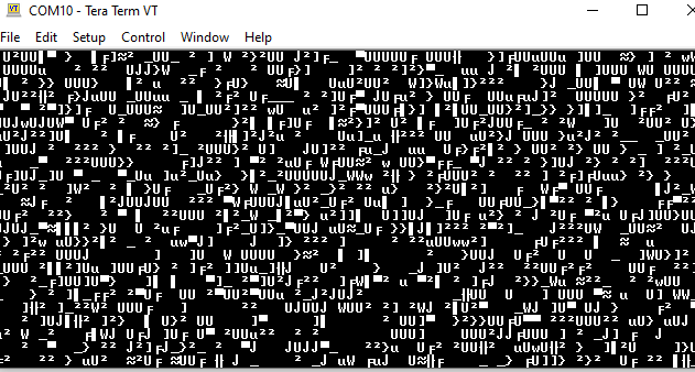

A different but somewhat related question I have now is after putting my program in the bootloader, I noticed that the uart interrupt no longer work correctly.
I'm receiving nonsense on my UART0 communication port. I tested out with the example program in the SDK (frdmkl25z_driver_examples_uart_interrupt) and the same thing is happening. Any ideas what is causing this?
Edit: I forgot to include but if either JTAG or USB port is connected then the UART behaves correctly but if they are both disconnected then I run into this problem.

huy_dang
Nevermind, I was just missing a common ground on the UART cable. Always check the hardware!
