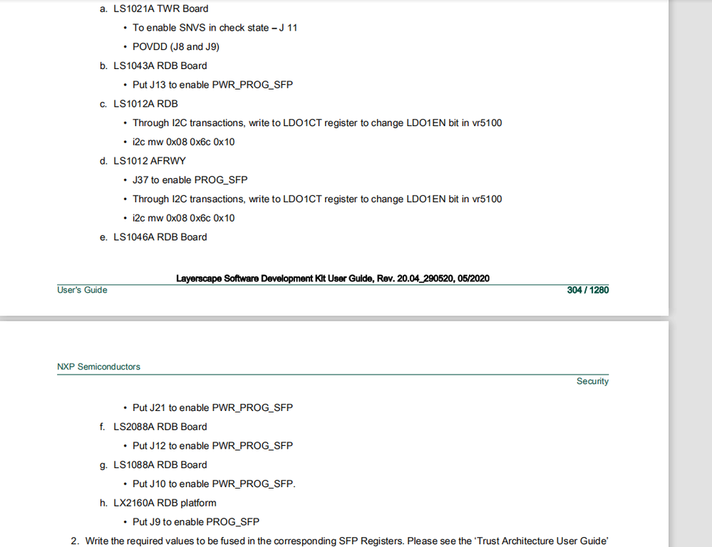

Please refer to section "6.1.5 Procedure to run secure boot" in document "Layerscape Software Development Kit User Guide 20.04" downloaded from" Layerscape SDK | NXP

I refer to this document, there is no safe boot procedure for ls1028 in the document.

To below OTPMK, put jumper on J28 (TA_PROG_SFP) to supply 1.8 V to PROG_SFP
