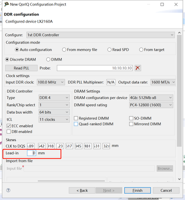

muaxi8
Contributor V
AS the following figure。there is a Lead-in paramter , don't know how to fill in this parameter, How do I get this parameter?
Thank you for your reply
11,194 次查看
yipingwang
No need to fill this parameter.
