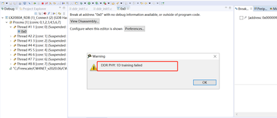

我用codewarrior连接我自己设计的Lx2080板子时,出现了下面的警告,请问可能是什么原因造成的。

Please download flexbuild_lsdk2012 and run "flex-builder -c ddr_phy_bin" to get DDR PHY firmware image build/firmware/ddr_phy_bin/fip_ddr_all.bin.
Please deploy DDR PHY FW at 0x00800000 on XSPI flash, block no. 0x04000 on SD card.

yes, I have programmed the fip_ddr_all.bin, but this Problems still remain

"DDR Initialization" section in "Target Initialization File" in CodeWarrior IDE is only used for NXP demo board, you need to modify "DDR Initialization" section according to your custom board.
You could use QCVS DDRv tool to assist you to calculate the initial DDR controller configuration parameters, then connect to the the target board to do validation and optimization.
