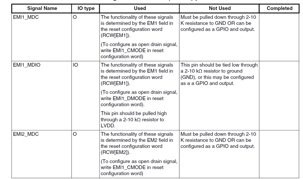

one more item, on the MDC and MDIO pins on the cpu, i have pull high of 1.5kohm and 4.7kohm. Maybe it's too high resistor value? Maybe I should reduce it to 200ohm and 330ohm... ?

yipingwang
Hello kl h,
Please refer to the following section in Ethernet Management Interface (EMI1/2) pin termination checklist.
EMIx_MDC could be left unconnected since it is an output.
I didn't find obvious problem in your modified u-boot source code. Please check the hardware design.
Yiping

Hi Yi Ping,
Thanks for the lookup on the codes. I follow your advise and check on the hardware connections again. Apparently, during P1023, I use common mdc mdio from cpu to both the phy Ethernet @ address 1 & 2.
Here I further do the modification and connect both phy’s MDC and MDIO to EMI1_MDC and EMI1_MDIO. Now I don’t get the error anymore.
When I type mdio list, I get
FSL_MDIO0:
1 – AR8035 < - - > FM1@DTSEC3
2 – AR8035 < - - > FM1@DTSEC4
FM_TGEC_MDIO:
1 – Generic 10G PHY < - - > FM1@TGEC1
Hence, I think the code FSL_MDIO0 maybe referring to EMI1_MDC and EMI1_MDIO and not EMI2…
