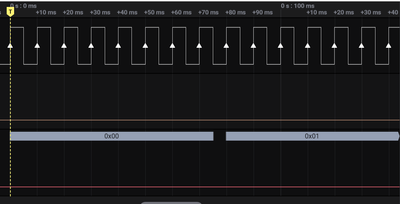

Hi all, I'm having problems with SPI, I'm not able to get it to go fast and the signal doesn't look staggered, I'm using the SPI_MasterTransferBlocking function and the LPC54628 test board.
I am using the SPI_MasterTransferBlocking function and the LPC54628 test board. If anyone knows how to make the signal go at a frequency of 100 Hz and not be staggered.
Thank you very much.
Best regards.

Omar_Anguiano
Hello Nadia.
Hope you are well. The 100Hz baud rate is not reachable when the flexcomm has attached the 12Mhz clock. I suggest you use a lower flexcomm source so you can reach 100Hz.
I used the FRO_HF clock and divided the frequency to reach 1Mhz.
Let me know if this is helpful, if you have more questions do not hesitate to ask me.
Omar
