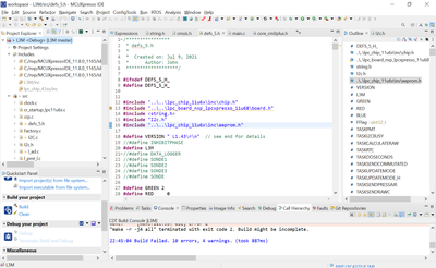

A screenshot of the project directory is shown below.  There are quite a few
red x's in the directory, including the src.  The include directory is now empty.
Any hints on how to proceed?  Thanks, jDrum

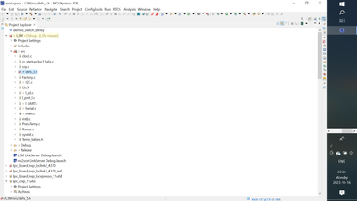

jDrum
Hello @xiangjun_rong
Thank you for your quick response.
We have made some progress by fixing the path names to the include files.  However, there are now additional errors in the build when the compiler reads the *.h files.
As shown in the screen shot below, the include section of the project explorer has the L3M/inc grayed out.  The question is how to make the includes active again?  Until we tried to import a backup, the includes worked well.
Thanks in advance, jDrum

jDrum
Hello again,
The following is a progress report on problems importing a saved project (or for that matter starting a new project in a new workspace).
Note that the above linker problem with the 1200 errors  was solved in a more recent post LPCopen linker problem: how to change the linker to the correct workspace?
We have often asked how one fixes the includes section of the project explorer
In principle, the create a new project wizard should handle this.  In our IDE (11_8), the wizard usually fails, and at least right now, can't even complete the task of starting a project.  (Is it written in a script that doesn't function on our computer?)  We have re-installed the IDE with no improvement.
In any case, we have looked into the operation of the eclipse software lurking behind the LPC compiler.
The project settings has a *.xml file that handles the includes section.  We "predict" that that file could be edited to fix the problem.  For example:
<language id="org.eclipse.cdt.core.gcc" name="C Source File">
<includepath>C:\Users\John\Documents\MCUXpressoIDE_11.8.0_1165\WS3M\lpc_board_nxp_lpcxpresso_11u68\inc</includepath>
<includepath>C:\Users\John\Documents\MCUXpressoIDE_11.8.0_1165\WS3M\lpc_chip_11u6x\inc</includepath>
</language>
<language id="org.eclipse.cdt.core.assembly" name="Assembly Source File">
</language>
<language id="org.eclipse.cdt.core.com.crt.mcu.assembly" name="Additional Assembly Source Files">
</language>
We were unable to attach the full *.XML file (not allowed by this forum)
In any case, the depths of the Edit project settings has places to type in the includes, for example, "lpc_chip_11u6x\inc".   Needs to be done in more than one place.

xiangjun_rong
Your issue is that the compiler can not find out the file which is included, so I suppose that you have to add the path so that the compiler can get the file.
Pls follow up the figure to add the path the including file is located.
Hope it can help you
