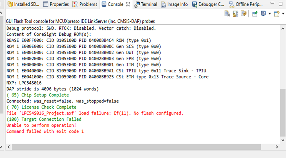

I am getting the same error, I have a custom board with controller lpc540s16.
If I have "Link application to RAM" selected, that means the controller should not touch the ROM and download and execute from RAM, is that right?
I get this error when "link application to RAM" is selected

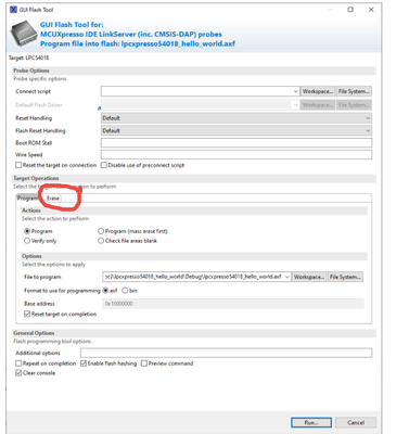

and I get this, when "Plain load image" is selected

Use the GUI Flash Tool ease the whole flash firstly.
If still work, please pressing ISP button in the whole erase/program or debug time .

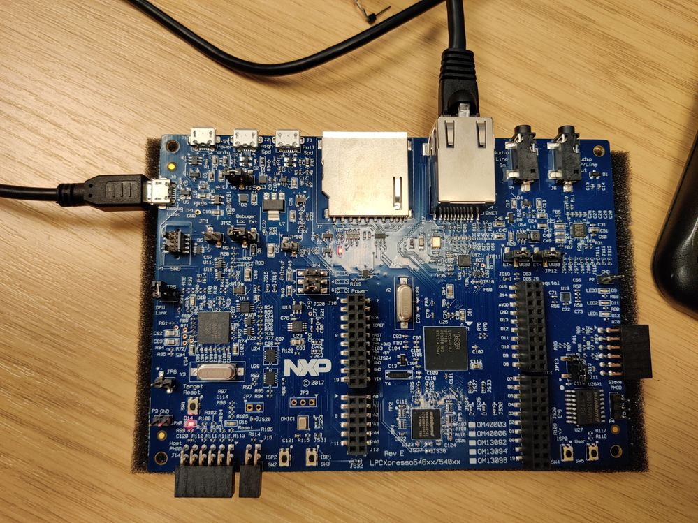

Here is how the board is plugged in:

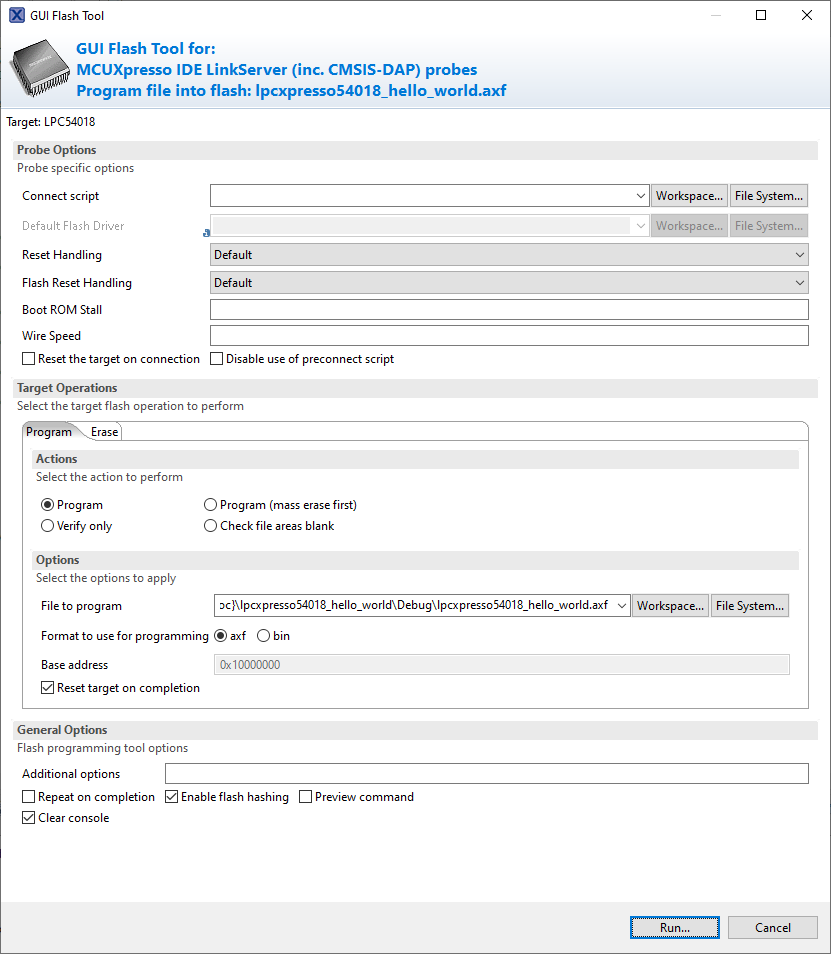

Here is the device selected in the GUI Flash Tool:
Here are the settings used when programming the board:
I have also tried to program using the .bin file generated by the build but also had the same error.
