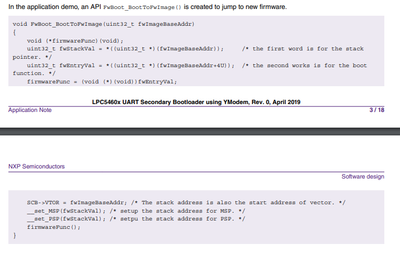

Pls refer to the an12384.pdf, which can be downloaded from the web site:
https://www.nxp.com.cn/docs/en/application-note/AN12384.pdf
This is the jumping code from bootloader to application:
pls refer to the code
Hope it can help you
XiangJun Rong

static void boot_tofwimage(unsigned addr) // depuis l'AN12384
void (*firmwareFunc)(void);
uint32_t fwStack = *((uint32_t*) (addr));
uint32_t fwEntry = *((uint32_t*) (addr + 4U));
firmwareFunc = (void (*)(void)) fwEntry;
SCB->VTOR = addr;
__set_MSP(fwStack);
__set_PSP(fwStack);
firmwareFunc();// let's go
What's seems weird to me: If I run my TestBoot app step by step, and the firmwareFunc() jumps to ResetISR() that restart the TestBoot !
