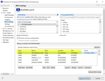

can i flash two different binaies at two different-2 location in external flash of LPC54S018 for testing whether it
is working correctly or not.
because i could se every time i'm programming the binary from any location using segger jlink swd debugger or even from GUI tool
inside the MCUXpresso ide, it flashes the binary always at 0x10000000 only but i want to flash at some other location
how can i do that??
any help would be appreciated!
4,688 Views
1) "can i flash two different binaies at two different-2 location in external flash of LPC54S018"
->> YES.
2) "inside the MCUXpresso ide, it flashes the binary always at 0x10000000 only but i want to flash at some other location
how can i do that??"
->> Change from memory setting as below, detail you can refer to <mcuxpresso IDE user guide>.
3) About secondary bootloader code, you can refer to flashloader project under SDK.
Alice

my controller is flashless..(doen't have internal flash)
i'm able to change load addresses in MCU setting in MCUXpresso ide and it is reflecting in linker file as well as in .map also.
but when load the program into device through jlink swd debugger either via inbuilt ide debug method or via Flash GUI tool in MCUXpresso ide
it shows programming Bank 0 @0x10000000 always...becuase it takes all the external SPIFI flash 128Mb as one bank only...
also it show it is erasing 128KB(2 sectors) but loaded program doesn't execute..
Even external flash has all the method to erase sector, block and chip through different command.
is it MCUXpresso ide limitation or device's bootrom bootloader is playing something.???
i'm stucked..
why this is not able to execute at two different memory location even a blinky program.
