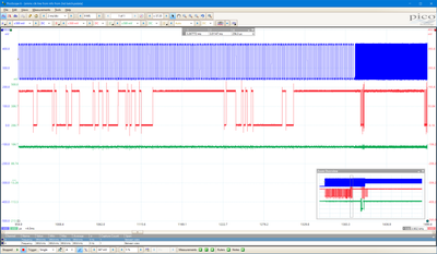

Hi we're using a LPC54608 with an external sandisk (sdinbda6-64g) eMMC memory device which is failing to complete the initialisation phase. (using sdk 2.7.0)
Having looked at the clk, cmd and d0 lines on the scope I can see the processor is sending cmd0 to put it into idle state then is in a constant loop sending cmd1 with the reply always showing bit 31 of OCR as busy (0).
The eMMC part is connected to 3V3 for VCC and VCCQ at 1V8 with power rails measured at 3.32 and 1.81
Is there anything on the nxp processor side that can stop the init phase?  Or any extra debug that can be turned on?
Kind regards
Ian

To close this off.
In the end we had to change the emmc part to an ISSI one which has now come up first time with no problem.
Below is the start up sequence showing the handshaking to up gears through the clock speeds.
The SanDisk part had a line in the hardware design manual that it needed the I/O and core voltage in a sequence outside of the normal jedec spec.
