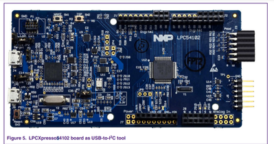

I want to use LPC804 in my project as a secondary controller which can be controlled using I2C master. I am going through LPC804 I2C Secondary Bootloader and found that LPC54102(image attached below) can be used as an I2C bridge between PC and LPC804.
As per my understanding, I can extend lpcusbsio source code attached in the below thread with source code I2C bridge firmware of LPC54102.
https://community.nxp.com/t5/LPCware-Archive-Content/LPC-USB-Serial-I-O-Library/ta-p/1129296
Can anyone please direct me to the source code of USB-to-I2C tools for LPC54102?

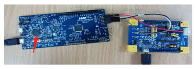

In AN11610,  The windows PC application talks to the SBL through the USB to I2C/SPI Bridge (implemented with LPC43xx) via NXP’s USBSerialIO library. There is no LPCXpresso54102 USB to I2C  code.
This situation is similar as AN12373 (Sorry I didn't notice you mention it in your original question)
Here we use on board LPC4322 firmware as USB-to-I2C bridge. The LPCUSBSIO is already burned into LPC4322, we just use it as bridge. that's to say, here below, we don't burn anything to on board LPC54102, just use the existing firmware ( as red arrow shows) as bridge. That's why you don't see any source code in our AN package.
LPCUSBSIO Works with MCU-Link Pro and on-board versions of MCU-Link and LPC-Link2
LPCUSBSIO is available as library format. I am afraid the source code is not open.

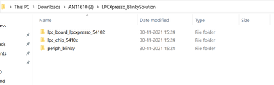

jayesh_joshi
@ZhangJennie
I have gone through the attached .zip file.
As per my understanding AN11610 is has an example of LPC54102 with SBL. I couldn't find a reference for LPC54102 as a bridge device. Can you please point out which example/binaries are you referring to?
Thank you for your support.

ZhangJennie
