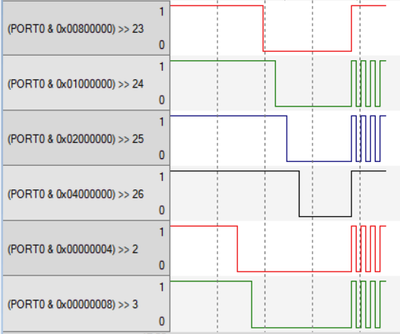

I have the following code:
	LPC_GPIO0->FIODIR |= (1<<2);	// P0.2 is output
	LPC_GPIO0->FIODIR |= (1<<3);	// P0.3 is output
	LPC_GPIO0->FIODIR |= (1<<23);	// P0.23 is output
	LPC_GPIO0->FIODIR |= (1<<24);	// P0.24 is output
	LPC_GPIO0->FIODIR |= (1<<25);	// P0.25 is output
	LPC_GPIO0->FIODIR |= (1<<26);	// P0.26 is output
	LPC_GPIO0->FIOCLR = ((1<<2) | (1<<3) | (1<<24) | (1<<25));	// Set PGC and PGD pins low
	LPC_GPIO0->FIOSET = ((1<<23) | (1<<26));	// Set MCLR pins high

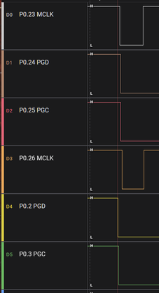

This is the output I get using a logic analyser attached to the port pins
I never asked for P0.23 and P0.26 to go low so why did they do so?
Puzzled, David

Hmmm that produces the following output:
So P0.23 and P0.26 don't toggle - its almost as if the setting of the pins to output has forced them low and after that all behaves as expected...
Removing the FIOSET and FIOCLR settings does in fact show that they are forced low when they are set to output mode.
Is there any way that can be controlled by a user program or is that fixed behaviour?
Thanks, David

Good news, the GPIO pins toggle as you expected.
After you write the GPIO direction register, for the first execution of the following instruction
It appears that all the port pins which are configured as GPIO output will response with the default FIOPIN register value, which leads to the problem.
If you do want to get deterministic pin logic, pls write the FIOPIN register value before you configure the GPIO direction register.
