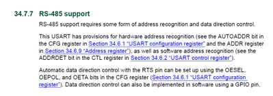

Then I referred UM
This too doesnt clearly state the implentation.

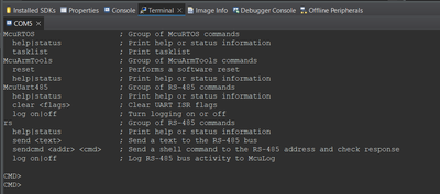

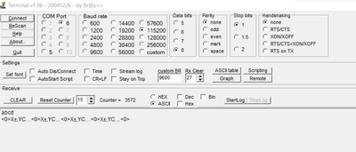

manasvb
I flashed ur project on my board
I used "rs send hi", (dont know why it didnt show up on the serial monitor)
On the RS485 recv side it shows this
To answer your above question -> without the transceiver, that is using normal uart my flexcom 2 worked, and for pull-up thing, I had used the same transiever for lpc2148 and it worked without the need for pullup

ErichStyger
Specialist I
The reason why you don't see the text in the console view is because it does not implement 'local echo'. This could be configured in other terminals or in the McuShell itself.

manasvb
That fine, but can you explain the random/garbage values
16,632 Views
ErichStyger
Specialist I
possible reasons:
  • floating pins
  • incorrect bus termination
  • incorrect baud
  • hardware FIFO issues
16,628 Views

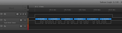

I noticed a strange thing
Firstly, this is my code for rs485
This is what i got on serial monitor
The very first time `RS485_Transmit()` is called it shows output correctly, after that its just random characters
(PS: RS485_Transmit() is in while loop with delay of 1sec between two consecutive function calls)

ErichStyger
Specialist I
a) have a look at the signals with your oscilloscope
b) just for making things simpler: for sending you don't need the interrupt, so for testing I would disable/not using it.

ErichStyger
Specialist I
Hi @manasvb ,
the 'magic sauce' is with that code piece I shared, plus muxing the RTS pin:
With RS-485, I cannot use 'full' handshaking, as it would require the CTS pin too. But all what I need is the RTS which is connected to both the RE pins of the receiver. With writing the CFG register I configure the UART to change the RE pin accordingly, to enable 'Tx' mode, otherwise being always in Rx mode.
