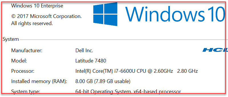

First of all, sorry for the later reply.
I did a test with [usbd_rom_libusb] example of lpcopen_3_02_keil_iar_lpclink2_4370 software package with LPC-Link2 board.
Below is my pc info for your reference:

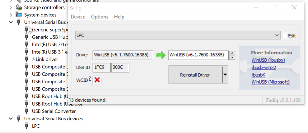

I downloaded [Zadig] v2.0.1 (Build 160) from here.
When I plug in LPC-Link2 board, I could find below device at PC device management:
If I replace WinUSB at Zadig and install the driver.
There will make below change:
For I don't have the LibusbK host side applications, I couldn't do related test.
If  you have the same behavior as my test?

I do have the same behavior on Zadig end. I am not able to transfer data though.
Vish
