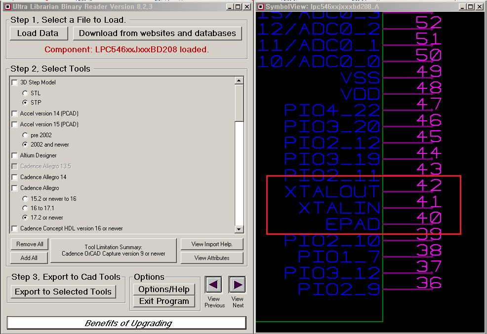

HI~!
I'm working on LPC546xxJxxxBD208 now.
I need your confirmation because the explanation is different.
< Symbols and Footprints >
https://www.nxp.com/downloads/en/symbols-footprints/LPC546xxJxxxBD208.bxl

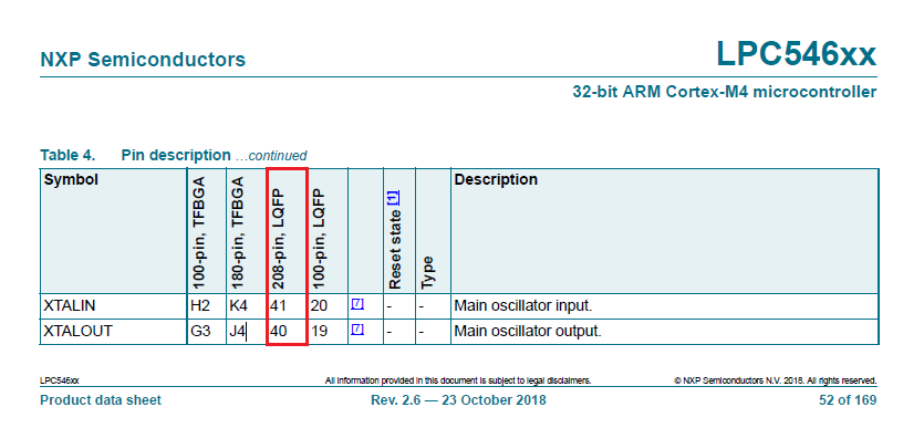

< Pin description from Datasheet >
What should I follow?

This problem was reported to design team.
It is confirmed that Foot print file of LPC546xxJxxBD208.bxl on NXP website has defect. Our datasheet is correct.
Our design team will fix it and put a new one on our site soon.
