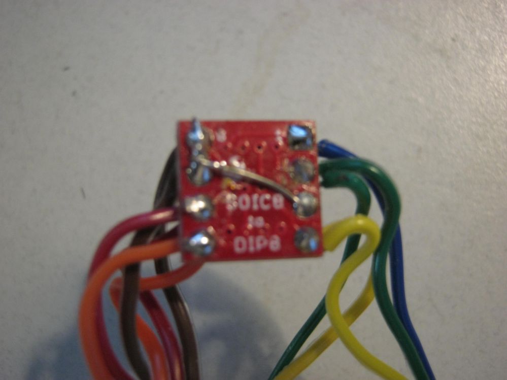

1. Share your 25AA02UID schematic, I need to check whether your external EEPROM circuit have problems or not.
   Pin 3 (Write-Protect) and Pin 7 (Hold) are active low. These are pulled up to Vcc (Pin 8).
2. Share the photo about the connection between the external EEPROM and  your LPCXpress 54114 board
In the left figure, as the board is *upside down*, Pin 1 is in the upper right. Can see Pins 7 and 3 connected to Pin 8 (Vcc=Vdd)
In the right figure all connections are to the upper row of the J4 PMOD connector *EXCEPT* 'Chip Select' which goes to J4, pin 7. NOTE that *unlike* DIP package, Pmod pin numbers go top-to-bottom (i.e., holding the board vertically) *on both columns*. Column 1 are pins 1-6, Column 2 are pins 7-12.
