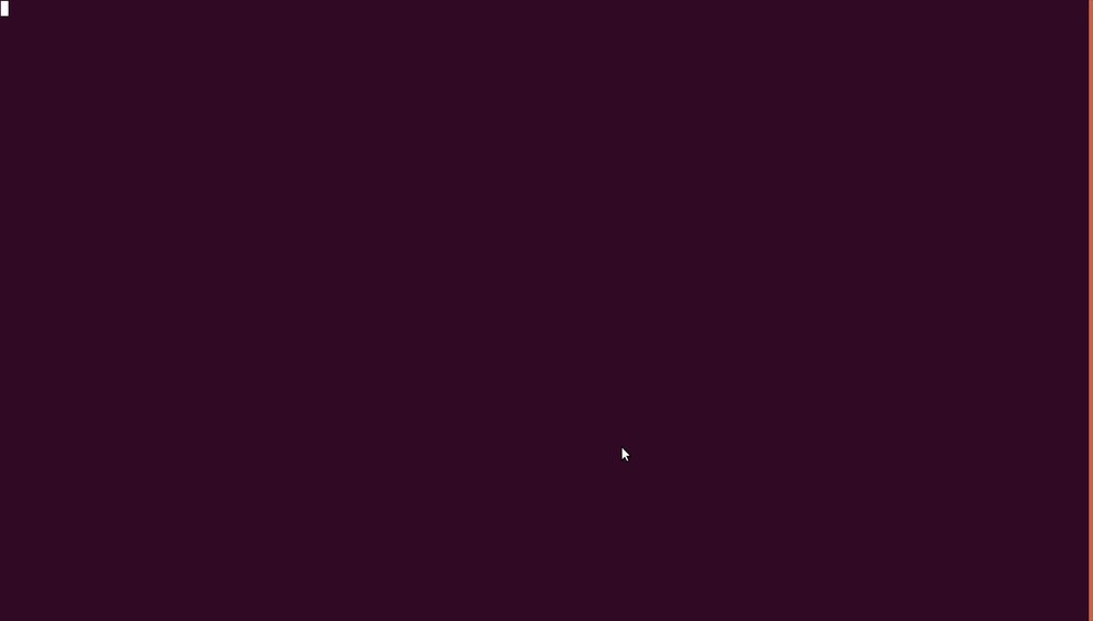

We are using the usbd_lib_cdc_uart code in debug mode on the OM13085 board. We are trying to get it to communicate with a serial terminal program called screen.
The device works perfectly fine on an Apple MAC:
It also shows up on the ls command and we have given the OS permission to access the serial port as well:
However, when we try to access the device using screen we don't get any output:
We also tried using /screen/ttyACM0 command but that also did not work:
We tried Putty terminal as well but somehow putty cannot connect to the device either.
Please advice if we are missing something.
Neel.

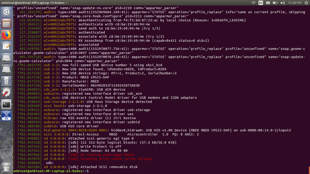

Hello Neel,
Does the device shows up using the "dmesg" command?
BR,
Aldo.
5,717 Views
ND2
Hello Aldo,
Yes it does show up in the dmesg command.
See attached screenshot
Neel.

If you notice the output of the ‘dmesg’ command you will see there is only one device on ACM which is the ACM0.
So there is no question of connecting to a different device.
