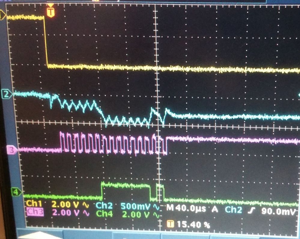

Still having trouble reading a UID code from a Microchip 25AA02UID attached to a LPC54114 Xpresso board. I have carved up a copy of the 'spi_polling_flash' project.
I can now see some action on the MISO line, but the returned values are not correct (i.e., still four bytes, all '0'). A potentially bigger problem is the clock doesn't seem active for the required number of cycles. Any suggestions ?

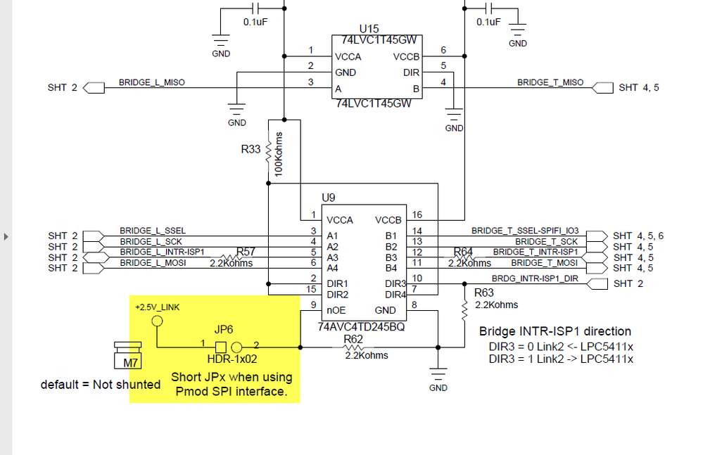

Hi James WHitney,
   Do you short JP6 on your LPCXpresso 54114 board?
This is very important when you use the PMOD interface.
From your last post wave, it seems your SPI didn't connected correctly.

jameswhitney
Good morning, Kerry,
Traces:
Yellow - Chip select
Blue - MISO
Purple - clock
Green - MOSI - Read command and address.

- Why *does not* the clock signal go for at least 32 cycles ?
Kerry, I matched up my signals/generation with the example that you suggested to Ronan and *everything* lined up exactly, so I know that my basic implementation is correct. Additionally, I have checked with the scope and 'CS', and command/address are also correct. Again for some reason - to me - it seems in my current case that the clock should be longer.

kerryzhou
Hi James WHitney,
Kerry

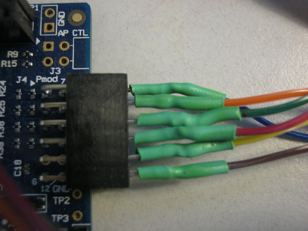

jameswhitney
1. Share your 25AA02UID schematic, I need to check whether your external EEPROM circuit have problems or not.
   Pin 3 (Write-Protect) and Pin 7 (Hold) are active low. These are pulled up to Vcc (Pin 8).
2. Share the photo about the connection between the external EEPROM and  your LPCXpress 54114 board
In the left figure, as the board is *upside down*, Pin 1 is in the upper right. Can see Pins 7 and 3 connected to Pin 8 (Vcc=Vdd)
In the right figure all connections are to the upper row of the J4 PMOD connector *EXCEPT* 'Chip Select' which goes to J4, pin 7. NOTE that *unlike* DIP package, Pmod pin numbers go top-to-bottom (i.e., holding the board vertically) *on both columns*. Column 1 are pins 1-6, Column 2 are pins 7-12.
3. The 25AA02UID VDD and VSS should powered by the LPCXpresso54114 board, it is 3.3V supply.
    They are: Vdd - J4, Pin 6 and Vss - J4, Pin 5  on Pmod connector
4. Provide your whole test project about the EEPROM, you can deleted all the other functions, just give me the simple project which can reproduce the problem.
       OK. I do not see the 'Advanced' icon. If I do not see it when I 'Post', I will attach to a separate mail.
  Please also tell me what the IDE you are using.
      Using MCUXpresso V10.3.0
5. Tell me the SPI pin you are using in the LPCXpressso54114, eg SPI_CS is J1_XX, then I will help you to test it, it will save both you and my time.
        SIGNAL           LPCXpresso Pin#          25AA02UID Pin #
         SPI_CS             J4, Pin 7                          Pin 1
        SPI_CLK            J4, Pin 4                          Pin 6
        SPI_MOSI          J4, Pin 2                         Pin 5  (SI)
        SPI_MISO          J4, Pin 3                         Pin 2  (SO)
        Vdd (+3.3)          J4, Pin 6                         Pin 8
        Vss (GND)         J4, Pin 5                          Pin 4
