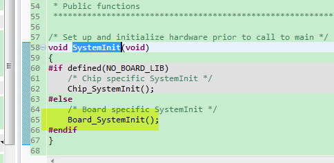

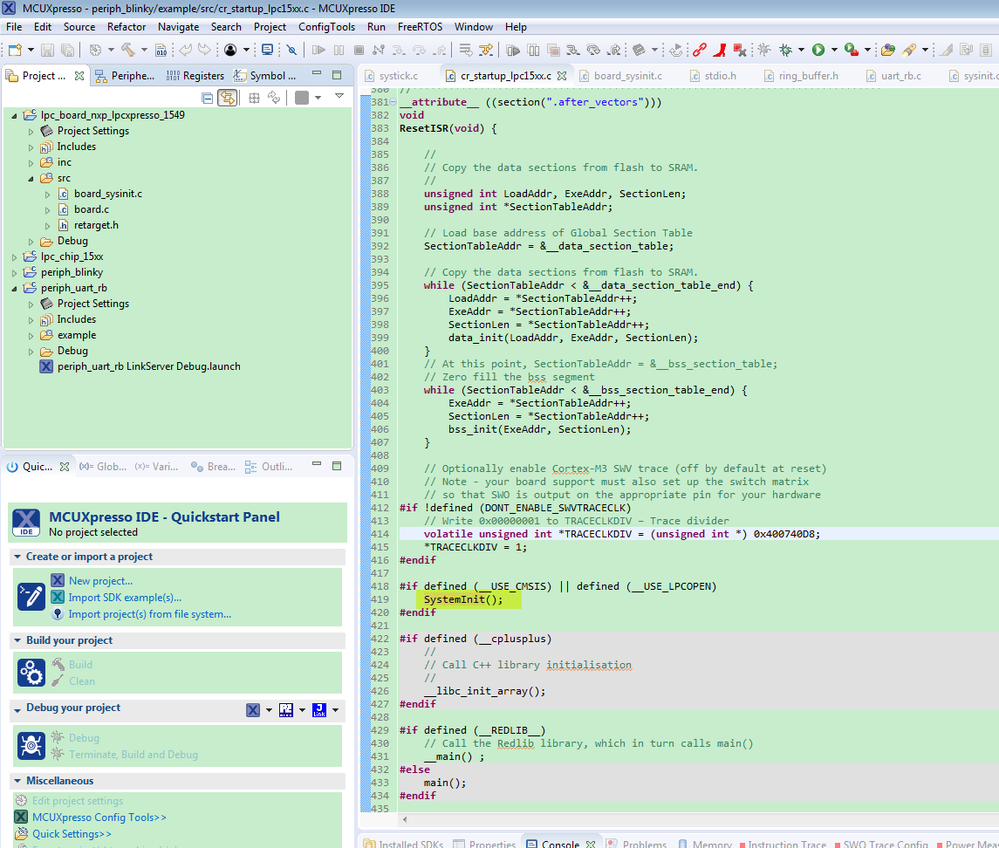

Hi ATHMESH NANDAKUMAR,
     Please check your cr_startup__lpc15xx.c file, ResetISR(void) function, this is the startup entry point after reset:
Enter SystemInit():
You can find on my side, it calls Board_systemInit();
You also need to check your code, you are calling chip_systemInit or the Board_SystemInit?
Do you test the official lpcopen code on your side?
Kerry

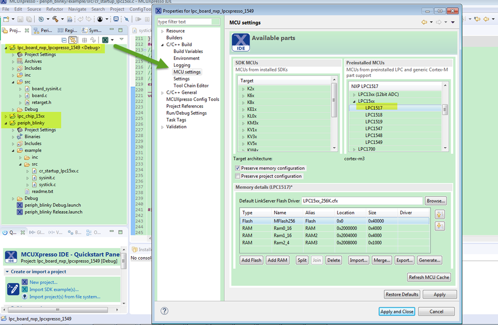

kerryzhou

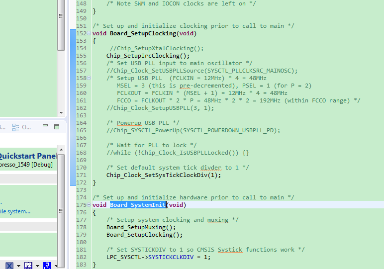

      What the code you are using?
     Do you use our lpc1549 lpcopen sample code on your side which just as what I recommended you?
     When you use the lpcopen code, as you know, there has two lib: chip lib and board lib.
     You need to change two lib MCU to LPC1517,
  Then if you want to use the internal IRC instead of the external crystal, you need to modify the board_sysinit.c function void Board_SetupClocking()
void Board_SetupClocking(void)
    //Chip_SetupXtalClocking();
     Chip_SetupIrcClocking();
    /* Set default system tick divder to 1 */
    Chip_Clock_SetSysTickClockDiv(1);
Then please build the lpc_board project again.
Now, please try it again.
Wish it helps you!
Kerry

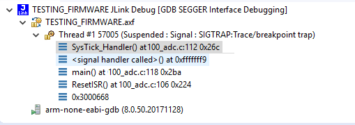

athmesh_n
Capture.PNGThis is how I initialized internal clocking.
There's an issue in Internal clock interrupt. The interrupt wont work always. I am using a delay_count++ in Handler. But sometimes this delay_count wont increment.
Debugging and putting a breakpoint in Handler does not have any effect, which means the interrupt is not working. This is my timer initialization snippet.
Thanks and Regards,
Athmesh Nandakumar
