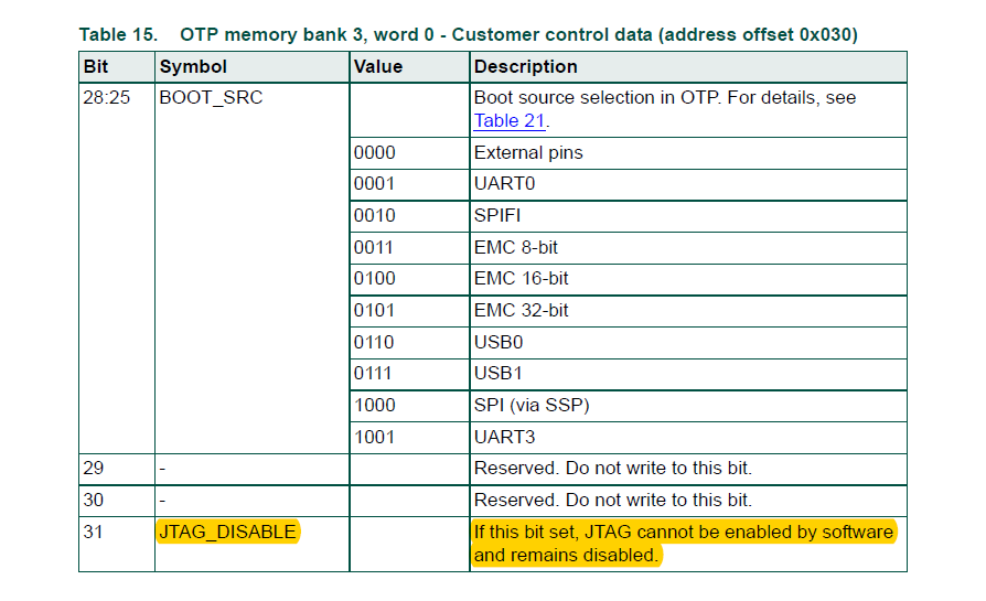

  From your post information, your 0x40045030 is  0x20000080, is it LE mode or BE mode? If BE mode, your JTAG_DISABLE bit is set, then the JTAG cann't be enabled by software and remains disabled.

Yes, it's LE mode, but 0x20000080 = 0b0010'0000'0000'0000'0000'0000'1000'0000 , bit31 is not set. but reserved bit 29 is set.

    It's my mistake, yes, you are correct, if it is the LE mode, the JTAG_DISABLE bit is enabled.

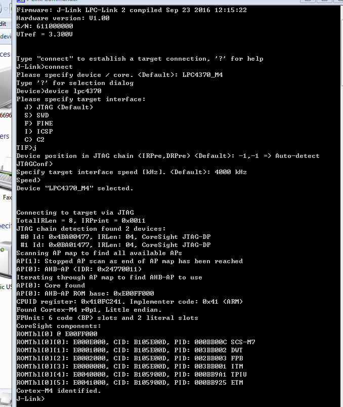

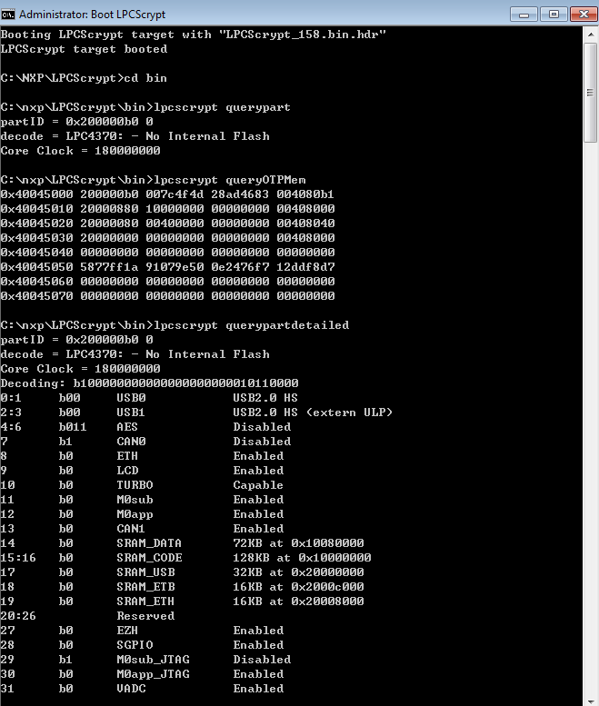

   I also check the OTP memory, this is my LPC-LINK2 information:
  Yes, your JTAG_DISABLE is still enabled, about the reserved bit, we can ignore the data.
  I have a question, if you the JLINK commander with SWD interface or JTAG interface, do you can connect your Cortext M4 core?
Kerry

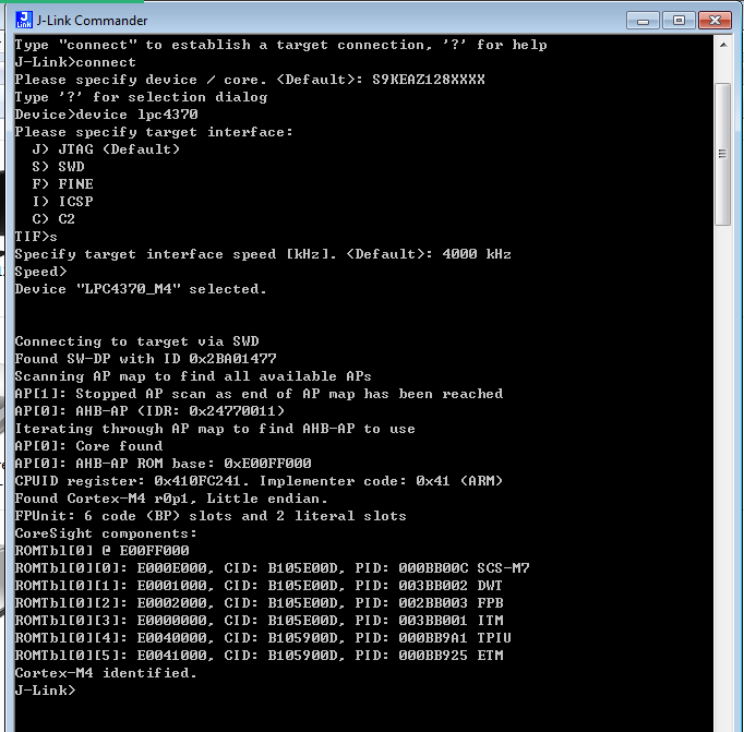

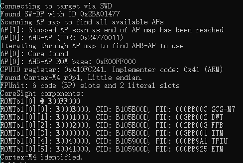

zhengyangqu
Thanks for your reply, Kerry.
This is my result.
I have M4 and M0APP cores access.
PS: On another board with M0SUB core access, the result shows 3 JTAG taps can be detected. I think your LINK2 may have the same problem.
